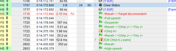

hello, I am porting a usb exploit applications from macosx to an imxrt1011 kit.
the code is copied from usb_host_hid_generic with some change (hid to dfu, and add some more wait states).

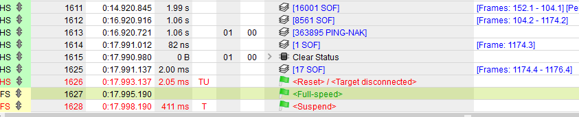

I found after a DFU_CLRSTATUS command, device is disconnect but doesnot reconnect after one second. (timeout error on suspend)
in PC's usb stack, it looks like this:
so I guess I need to force a soft reset after an dfu clear status control message (like IOUSBDeviceInterface->ResetDevice  under osx or libusb_reset_device under linux).
I tried call
            if (USB_HostDeinit(&g_HostHandle) != kStatus_USB_Success) {
                usb_echo("host deinit error\r\n");
            status = USB_HostInit(CONTROLLER_ID, &g_HostHandle, USB_HostEvent);
            if (status != kStatus_USB_Success) {
                usb_echo("host init error\r\n");
in one of my step but it just cause a hardfault.on USB_HostDeinit.
a single USB_HostInit call doesn't fix suspend timeout error, too.
is there any examples to do a device reset in host side?
