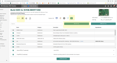

kerryzhou
Hi @mastupristi ,
  The main issue is you need to select the tool chain as all when you generate the SDK:
In the lwip_nghttp2cli_mbedTLS demo, you can find:
Toolchain supported
- IAR embedded Workbench 9.10.2
- Keil MDK 5.34
- GCC ARM Embedded 10.2.1
So, this demo can't support the MCUXpresso IDE.
