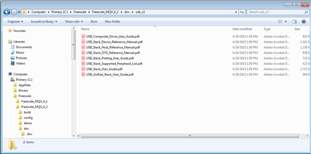

danielchen
Hi Scott:
As far as I know, the usb stack v5 is integrated into MQX 4.2.
I think you can refer to the docs under the MQX 4.2 installation folder.
C:\Freescale\Freescale_MQX_4_2\doc\usb_v2
