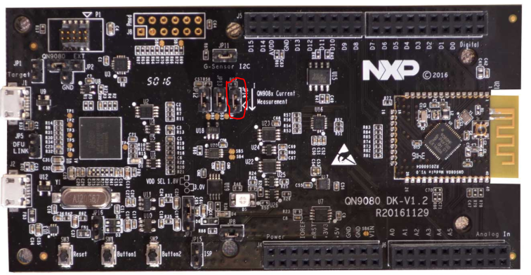

I am using QN9080 Eval kit. I am using qn908xcdk_wireless_examples_bluetooth_wireless_uart_freertos demo application. I want to put the system in Sleep mode. So I have enabled the configuration for sleep mode. But when I call POWER_EnterSleep() API at that time __WFI(); instruction is not working. I always come out from the __WFI(); instruction.
Am I doing anything wrong?

Hi Kaival Shah,
 When you enter some power mode without including the RUN mode, the debugger won't allow to change between low power modes. I suggest to use a multimeter and check the current in the JP14:
There you'll be able to see the current consumption of the MCU.
I hope this can help you.
