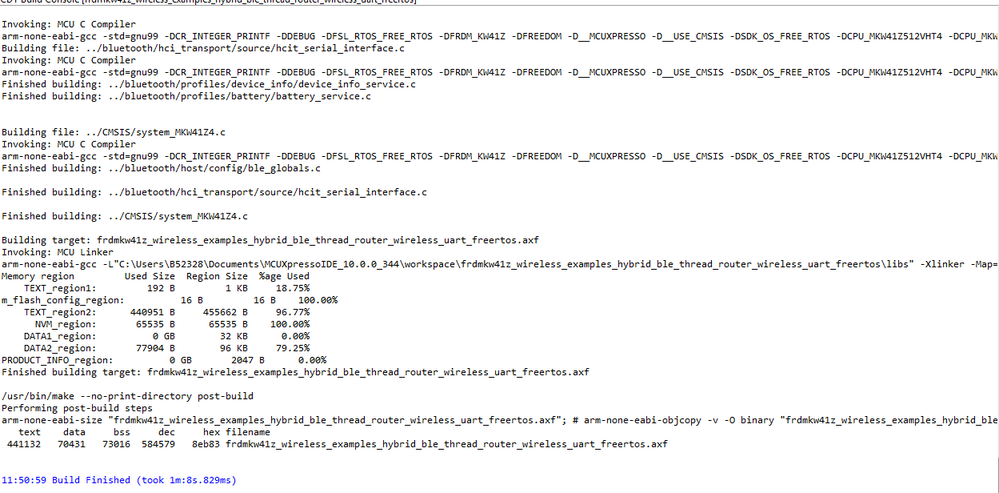

How did you import the project? I compiled it with no errors.
Could you please give me more details on how are you working with the example?
