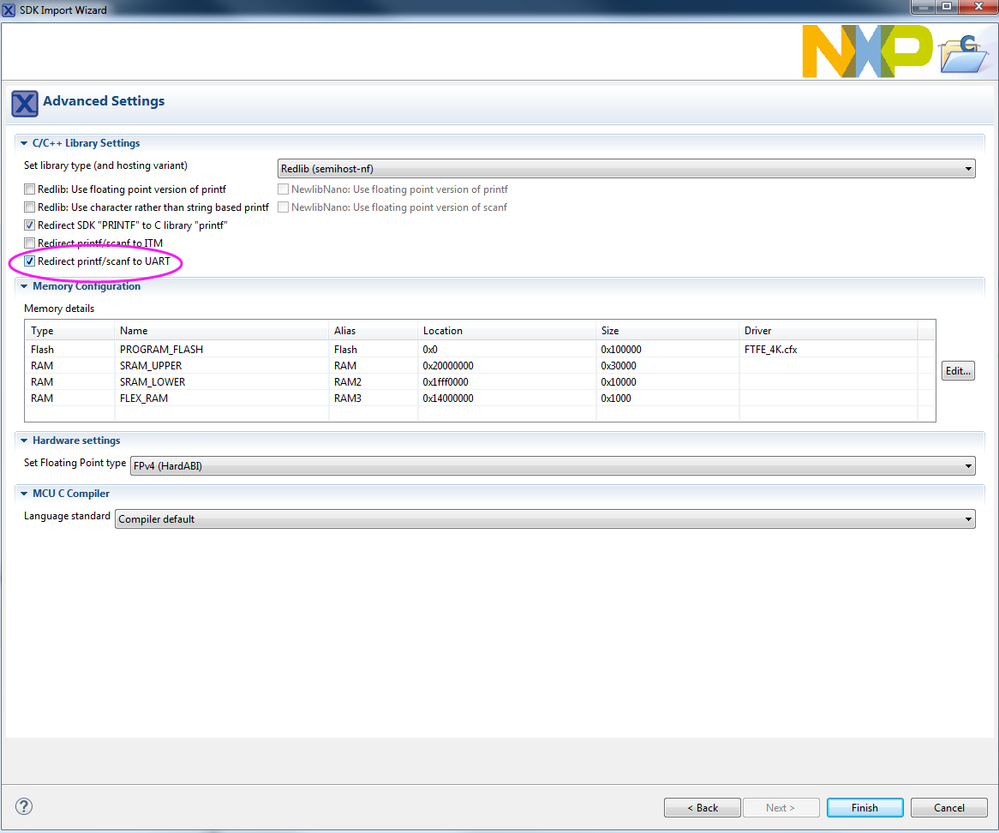

Just got the the 54608 ev board, I have the latest MCUXpresso IDE along the latest SDK for the board.
I've imported the simplest sample I could find (gpio_led_output) , compiled clicked debug and .. It worked as expected.
However, once the debugger was detached the board went to its previous state, as if the program was executed from RAM. How can I forced the software to be retained after debug is over ?

Hello Eitan,
Please check the "Redirrect print/scanf to UART" when  import SDK project :
I t will download to flash.
When open SDK project, the default configuration is print to console using C lib, in this
Way, the project can’t download to FLASH.
TIC
