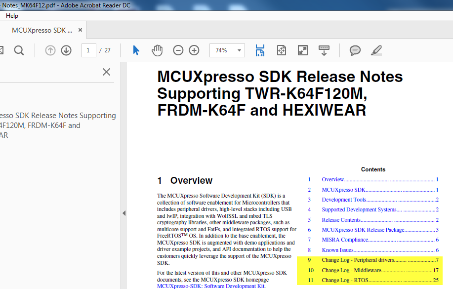

Hi, where do I find release notes for MCUXpresso SDK?  I.e. what has changed (drivers, bugs, etc) from 2.2 to 2.3? Especially at the end of projects, I need to consider the risk of upgrading SDK in order to decide what to do.
1,321 Views
ZhangJennie
Hi Eldar,
please go to SDK 2.3 package /doc folder, there is release note pertaining to this folder.
Open it, see change log sections
The change log sections record what changes in each version history.
