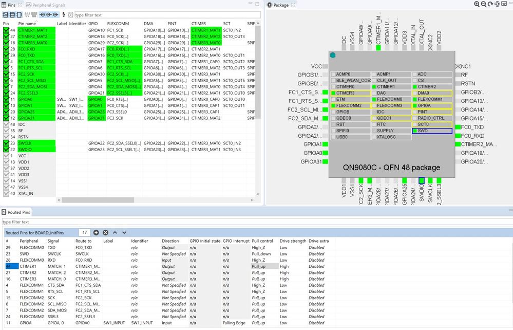

Hi, I'm sure I'm doign something stupid here, but I have created a new project for my QN9080DK and set it up using the pin configuration tool. I set up various GPIOs, interrupts and ports (SPI, PWMs).
When I then compile it, I get a load of errors that suggest it can't find fsl_gpio.h. It is listed in the files in the project explorer, but I can't work out where to include it in the source code.
The errors I get are as follows:

I see from your video that you started with one of the demo projects. If I do this, mine compiles as well, but i wanted to start with a "clean" project, so I followed the instructions in section 6 of the MCUXpresso IDE USer Guide to creat a new project using installed SDK part support (my guess is that it is here that I have gone wrong).
I have also attached an image of my pin setup. When the project first opened and only had one of the debug pins selected, it compiled fine.

Hi Jon,
I was able to reproduce your issue. It's caused by missing #include "fsl_gpio.h" in the generated pin_mux.c file when GPIO pin direction is configured in the Pins tool.
Attached you can find patch with hot fix of the issue. To apply the patch, please copy the content of the archive into the tool's data folder:
  • Windows: c:\ProgramData\NXP\mcu_data_v5
  • Linux/Mac: /home/<USER>/.nxp/mcu_data_v5
This issue will be fixed in the next MCUXpresso Configuration Tools release.
Thank you for reporting this issue and we are sorry for the inconvenience!
