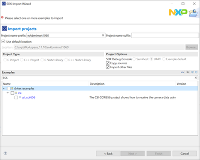

abady1000
Hello @Gavin_Jia , I just wanted to let yo know that example you mentioned for chip 1060 is also for progressive bt656, I wonder if any thing new came up until now?

For that reason I have SLN-TLHMI-IOT board which utilizes RT117x chip and has a parallel CSI empty connector I am planning to use in order to receive BT656 stream.
I am currently able to run custom applications on the SLN-TLHMI-IOT board and want to try BT656, does CSI IP has similar registers map in both RT1170 and RT1060? would that example be useful to follow ?

Yes, it seems to me that the RT series of MCU have been designed to be as stylistically coherent as possible. The IP should be consistent, and you can absolutely refer to the implementation in the RT1060.
