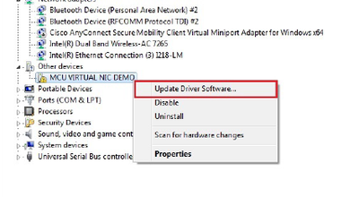

| was able to replicate this, only changed this descriptor macro to this value:
#define USB_CDC_VNIC_CIC_SUBCLASS (USB_DEVICE_SUBCLASS)
It does not enumerate completely as I need to update the driver with the files on the example but security features of my PC do not allow me to update this.

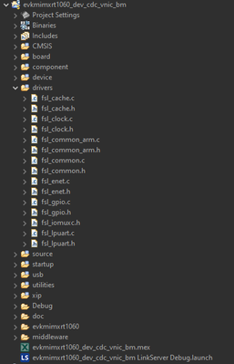

You imply that if a driver is installed on the host PC, it will enumerate. Where does one find this driver? I cannot see any folder in the project tree which seems to contain a relevant Windows operating system driver file:
1,820件の閲覧回数
Omar_Anguiano
The driver is located at the SDK project location ...\boards\evkmimxrt1170\usb_examples\usb_device_cdc_vnic\inf
