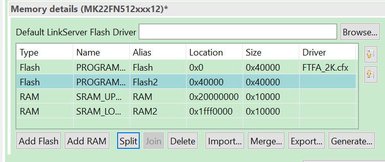

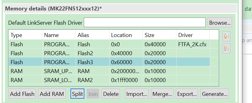

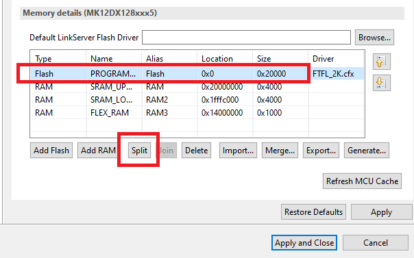

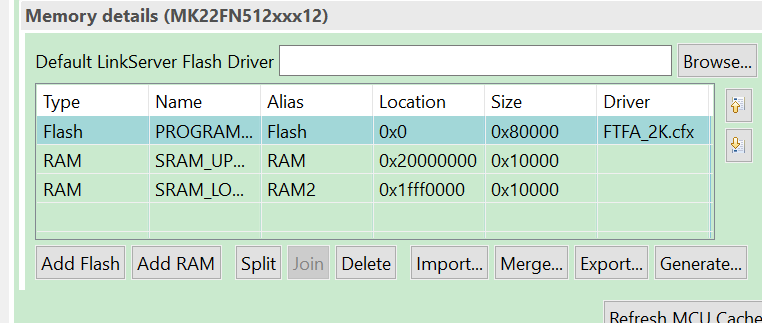

I have a question, is there any difference between
int partition_flash(int eeprom_size, int dflash_size)
and splitting the flash in the properties?
Thanks.
2,619 Views
kerryzhou
Hi mylim,
   Split function is just divide the original defined flash range to a lot of other range and length:
Split is not the partition, you can consider it as the linker file flash definition.
but EEPROM partition means use the flexNVM as the EEPROM backup area, use the FlexRAM as the EEPROM emulated address.
More details, please check the kinetis reference manual flash chapter, find the eeprom partition, you will be more clear about it.
