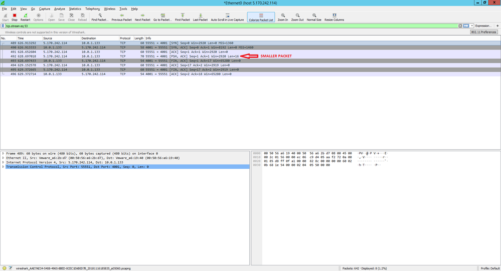

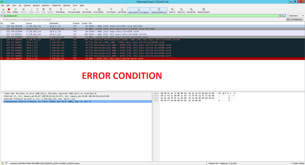

The problem occurs only when the bigger packet is sent and the first timeout occurred on the recv function (I can see the "WAIT SERVER" message on the debug monitor only once), but it doesn't occurs all the times these conditions are present.
The assertion occurs on the pbuf_free() function at the instruction LWIP_ASSERT("pbuf_free: p->ref > 0", p->ref > 0);

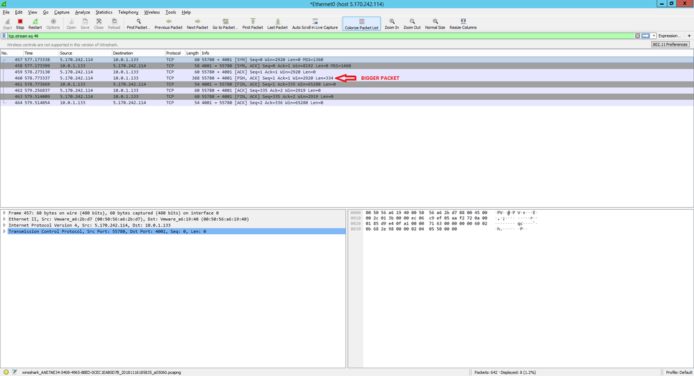

The image below shows the Wireshark captured session of the smaller packet:
The image below shows the Wireshark captured session of the bigger packet:
The image below shows the Wireshark captured session of the error condition; note that the TCP Retransmission packets are present because the device is stopped on the breakpoint:

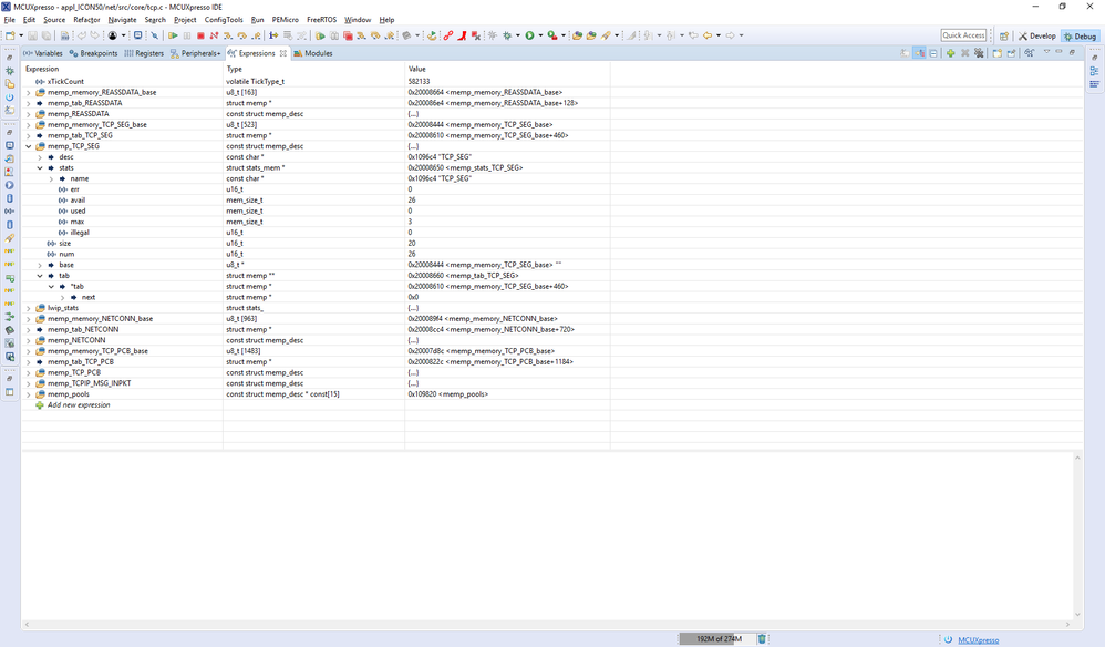

This is another situation maybe caused by the same issue:
Something to notice in the memp_TCP_SEG variable: the stats struct shows that no element is now used and the maximum number of elements ever used from the application start is 3. The tab variable points to the linked list of all free elements: having now no used elements, the linked list should link all the elements (26), but as it can be seen, there is only one element in the list.
How can it be generated?
