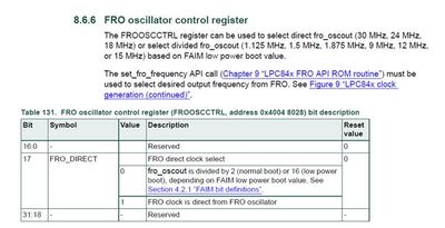

The LPC845 Users Manual shows FRO_DIRECT as Bit17 in the FROOSCCTRL Register but the CLOCK_GetFroFreq code looks like it's checking Bits 1:0.

Hi, JDFAE,
I have checked the code, I think the code of uint32_t CLOCK_GetFreq(clock_name_t clockName) is correct that checking the SYSCON->FROOSCCTRL[1:0] to determine the FRO clock source.
Although the SYSCON->FROOSCCTRL[16:0] are RESERVED in the UM11029.pdf, but they are changed with different FRO oscillator frqeuency, they do make sense.
Based on LPCXpresso845MAX board, I have tested the following code and check the SYSCON->FROOSCCTRL value, this is the result:
1)case 1
POWER_DisablePD(kPDRUNCFG_PD_FRO_OUT); /*!< Ensure FRO is on */
POWER_DisablePD(kPDRUNCFG_PD_FRO); /*!< Ensure FRO is on */
__asm("nop");
Result after running:
SYSCON->FROOSCCTRL=0x16B75 in Debugger, in other words, the default is 24MHz FRO, SYSCON->FROOSCCTRL[1:0]=01 in binary.
2)Case2
CLOCK_SetFroOscFreq(kCLOCK_FroOscOut30M); /*!< Set up FRO freq */
__asm("nop");
SYSCON->FROOSCCTRL=0x16BBA in Debugger, in other words, the FRO is 30MHz FRO, SYSCON->FROOSCCTRL[1:0]=10 in binary.
3)case3
CLOCK_SetFroOscFreq(kCLOCK_FroOscOut18M);
__asm("nop");
SYSCON->FROOSCCTRL=0x16B98 in Debugger, in other words, the FRO is 18MHz FRO, SYSCON->FROOSCCTRL[1:0]=00 in binary.
Hope it can help you
XiangJun Rong
