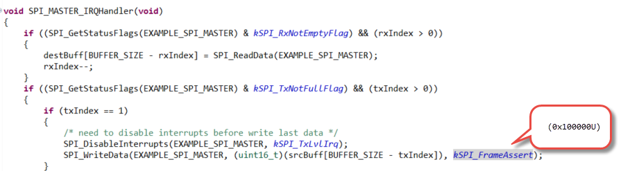

I am using LPC54606 interfacing ADS8668 over SPI. Flexcomm2 (PIO1_23 to PIO1_26) is being used for the same with SSEL0. I am using MCUXpresso IDE and SPI driver provided in SDK.
I observed that even after transmit is over CS/SSEL0 pin remains low. (SSEL0 pin remains low all the time).
Due to this ADC is not able to start the conversion and so on as it requires CS to go from HIGH to LOW.
Please suggest how can CS/SSEL0 deasserts itself when there is not data transfer over SPI.

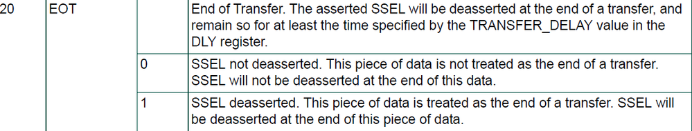

We need to set the End of Transfer (EOT) to 1 in SPI FIFOWR register.This piece of data is treated as the end of a transfer. SSEL will be deasserted at the end of this piece of data.
You can find the code in SDK  SPI demo:

Thanks you very much Alice_yang.
Yes, I did the changes as per your suggestion and it worked for me.
