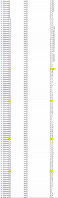

For our project we would like to write multiple 'data records' into flash memory.
Each record  contains 100 bytes.
From my understanding we need to write in blocks of 32 bytes.
Therefore we increased the amount of bytes 'written' to 128 (4 * 32).
We still request the function 'Flash_Program()' to write 100 bytes but increase the write 'pointer' location by 128 bytes after each write.
As required we first erase the flash page ( flash location used to start: 0x59000) .
Then we request to write 100 bytes to be written into it.
The first request is verified successfull. We did read the 100 bytes back that we did write into it.
The pointer is then increased by 128 (4*32 bytes). (0x59080)
Then we request to write another 100 bytes into flash.
But is fails every time. Every single time the same 4 bytes are not read back as the value we requested to be written into it.
All other 96 bytes are written in correctly.
Code is attached with this ticket.
I have used the SDK example "k32w061dk6_flash_demo"  as a base.

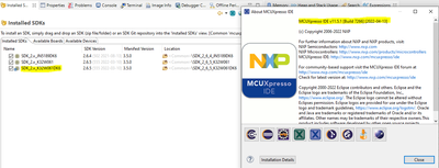

Installed:

Emiel1984
Maybe I'm misunderstanding your input but this specific line only ensures that I erase every page before I start writing into it.  0x59000 \ 512 ==  flash page 712  (712* 512 == flash address location 0x59000) .
if (FlashBufferHead % 512 == 0)
My 'record buffer' starts at the beginning of a page but is multiple pages in size.
I do not want to write the records for an entire page at once because this means I need to buffer them elsewhere untill I have enough to fit.
I want to avoid creating another buffer to store records into before writing them into flash.
From my understanding the only requirement for writing bytes into flash is that we need to write at least 32 bytes at a time.
And for reading we need to read at least 16 bytes at a time.
We can't only erase a page during initialisation. We need to be able to erase\overwrite older records over time.
In my code I request to write 100 bytes at a time.
So what I expect that happens is ( confirmed this in debug
--run0
Flash page 0x59000 is erased  (because FlashBufferHead point to the beginning of a page).
100 bytes in written.  0x59000
FlashBufferHead  gets value 128.
--run1
100 bytes in written.  0x59080
But here we get the issue that when I read the values back from flash.
These are different as mentioned in the topic start. We did already erase this part of the flash during run 0.
FlashBufferHead gets value 256.
--run2
100 bytes in written.  0x59100
FlashBufferHead gets value 384.
--run3
100 bytes in written.  0x59180
FlashBufferHead gets value 512..
--run4
Flash page 0x59200 is erased  (because FlashBufferHead locates to the next page)
100 bytes in written.  0x59200
FlashBufferHead gets value 640..

Emiel1984
As a test I changed the start address to 0x59080.
Then the same behaviour applies.
The first 100 bytes are written in correctly.. the next run  the same bytes (as in the screenshot above)are again wrong.
Looks like the exact same values are written, because these 'wrong' values\bytes are exactly the same (but now on a location 128\0x80 bytes later in the flash page).
At (index==value) 35== 3, 51==59, 70 =102, 86==94)
