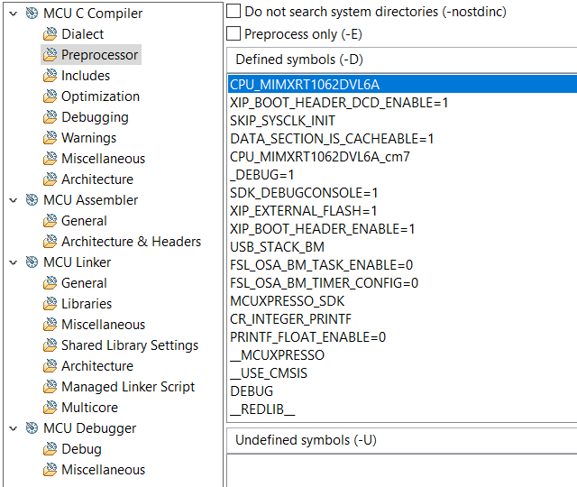

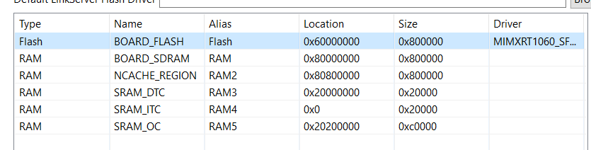

Hi everyone,
I was trying to get the USB Host MSD Command bare-metal example to work when using the external SDRAM. The example was modified to work with a custom board I have (added DCD to setup XIP w/ QSPI flash and SEMC for SDRAM, VBUS control), and the modified example works when using SRAM_DTC; my USB drive enumerates and the test executes successfully.
However, when I modify the example to use SDRAM instead of SRAM_DTC, my USB drive fails to enumerate. It appears that the stack doesn't receive any data, causing it to timeout the enumeration process.

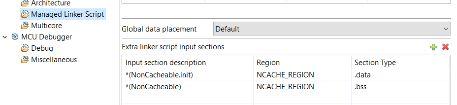

I had seen that other people had issues with parts of the SDK not working when buffers are located in cacheable memory, so I went through and updated my project based off the following posts, and I could see that some of the USB buffers moved to the non-cacheable region I defined in SDRAM. However, my drive still would not enumerate.
Using NonCached Memory on i.MXRT
MCUX on RT1050 - MMC stack won't initialize
IMXRT1050 USB DEVICE examples fail to run from OCRAM
My main question is: How can I get the USB stack to work with a non-cacheable section defined in SDRAM?
Below I've attached parts of my project setup in case I've missed something.

Hi @jg_sung ,
The USB MSD example can work with all data in SDRAM. The key is put all the buffer used by both hardware and software in noncacheable area. You must check them carefully.
https://community.nxp.com/t5/i-MX-RT/USB-Host-enumeration-fails/m-p/1436138
