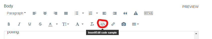

PS: Pro Tipp - If you want to add code samples to your posting, readability is greatly improved when you use the "Insert/Edit code sample" function, see screenshot below.
PPS: I think that it is not helpful to add a code sample if you just want to point to a certain function in a certain file and do not discuss the code you are presenting.
