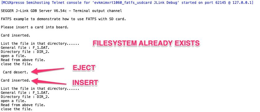

Hi Jack,
I made a demo base on the example evkmimxrt1060_fatfs_usdcard. It seems you don't need to do anything after desert.  The files in SD card is created by original fatfs_usdcard project.
Jing

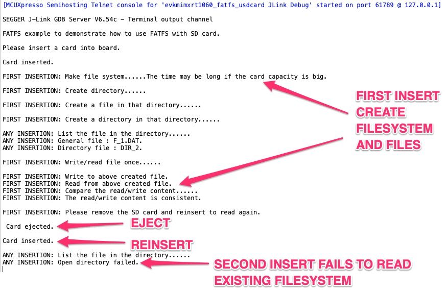

My test case is a little different.
I see in your example you did not MKFS and create the files on first insertion, assuming they were created some other time:
local_workspace_-_evkmimxrt1060_fatfs_usdcard_source_fatfs_sdcard_c_-_MCUXpresso_IDE.jpg
In my example I create the filesystem and files on first insertion each time and then the reinsert fails.
I have modified your example and tested, here is the output:
I am attaching the modified project, which I also changed to use semihosting with a J-Link, linked to RAM.

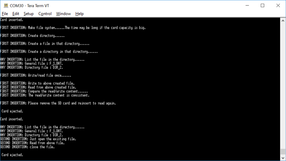

jingpan
It is strange. You code works fine on my board.
Can you try another card?
Jing
