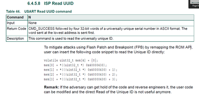

xiangjun_rong
You can read the UUID which can be viewed as serial number.
For detailed inf, pls refer to the section 6.4.5.8 ISP Read UUID in UM11155.pdf, which can be downloaded from the link:
https://www.nxp.com/webapp/Download?colCode=UM11155&location=null
There is also ID number for the LPC family, pls refer to section 8.5.99 Device ID0 register
Hope it can help you
XiangJun Rong
2,590 Views
brian_ungar
The ID that you reference is for the USART. I want to access (via an SDK API) the unique information about the board (LPCXpresso54S018).
2,584 Views
xiangjun_rong
Regarding your question about the unique information about the board (LPCXpresso54S018), i suppose there is NOT unique information about the LPCXpresso54S018, all boards are the same.
