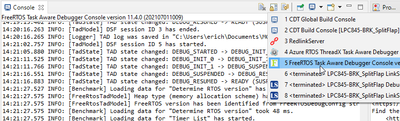

I have been trying for using FreeRTOS Task Aware Debug features for the example project "lwip_httpssrv_mbedTLS_freertos" in SDK. During debugging of this code while trying to examine the Task List, Queue List, Timer List and Heap Usage from FreeRTOS menu option, none of these items is visible! The Information message "FreeRTOS has not been detected." is displayed in the FreeRTOS TAD Views section.
IDE Debug mode is All-stop and other care has been taken as described in MCUXpresso_IDE_FreeRTOS_Debug_Guide.pdf.
For other SDK examples for FreeRTOS, there are no issues for FreeRTOS Task Aware Debug.
I would like to know is there any specific settings missing for "lwip_httpssrv_mbedTLS_freertos" project example in achieving FreeRTOS Task Aware Debug views?

can you check what the console output for TAD is?
8,514 Views
Bhaskar_Thakker
Debug console for TAD shows error as following.
18:14:55.220 ERROR: [VariableReader] Could not read variable expression: "sizeof(pxReadyTasksLists)".
