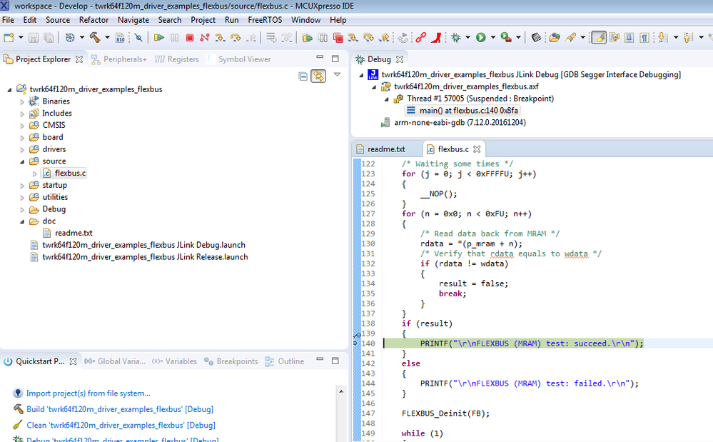

I've downloaded an MCUXpresso 2.2 SDK for the TWR-K64F120M. I imported the flexbus driver example and successfully compiled and loaded the code. When I run the code, it prints out:
FLEXBUS Example.
Initialize FLEXBUS.
Start write/read MRAM.
FLEXBUS (MRAM) test: failed.
I haven't modified any code, so I would expect it to succeed. Has anyone else had this work?
I have the flexbus working correctly on the same board using the KDS3.0 and KSDK1.3.0. I was trying to port this working code to the new MCUXpresso environment and was having issues, so I figured I would build the example to use as a reference. Since the example doesn't work, it doesn't serve as a useful reference.

Hi Larry:
I did a quick check about this demo, it works on my side. I would suggest you check the jumper settings in your TWR-MEM board.
