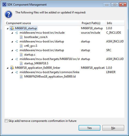

I am using the RT1050-EVK and the SDK I created has FatFs, but it is an older version that does not allow f_open (RW), only Read or Write. There are a number of improvements like more conventional syntax for mount points.
I know I could just include the newer version of FatFs in my project, but I like the glue that MCUXpresso provides with the devices I enable as needed.
The SDK version is R0.12c and the current release is R0.13c
If I swap out the files and I "Refresh SDK" will the files get reverted to the older version?

Hi  Tom:
The latest SDK version is 2.5.0.
The fatfs version is R0.13b (April 07, 2018)
If you click the 'Refresh SDK'
The will be a SDK component management wizard will guide you through the update process. Like this
So I think you have an option to not updated.
