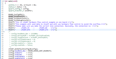

Please provide or guide me to find an example project in MCUXpresso IDE that support LPUART RTS/CTS hardware flow control.

Currently we  have lpuart_hardware_flow_control demos for the RT10xx series. You can use as reference  lpuart_hardware_flow_control of the the RT1060 SDK. This demo simple enables the RTS/CTS pins and uses an config structure. The demo is intended to work on a self loopback mode.
I have not tested this yet, on our RT1176 EVK, but I think the LPUART API should support you to enable this functionality.

Hi Diago,
Could you please send me the link to  lpuart_hardware_flow_control demos or direct me how to find it?
