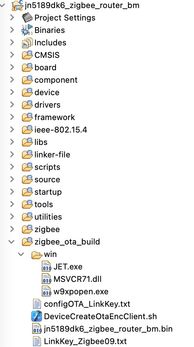

IDE version:
sdk version:
import SDK example
the jn5189dk6_zigbee_router_bm
build(after  chmod 777 DeviceCreateOtaEncClient.sh in terminal)

I did terminal : chmod 777 DeviceCreateOtaEncClient.sh
then error is ?.exe
Binary size is 00030d30 (199984) copy from `jn5189dk6_zigbee_router_bm.axf' [elf32-littlearm] to `jn5189dk6_zigbee_router_bm.bin' [binary] ../zigbee_ota_build/DeviceCreateOtaEncClient.sh: line 23: win/JET.exe: Permission denied ../zigbee_ota_build/DeviceCreateOtaEncClient.sh: line 26: win/JET.exe: Permission denied ../zigbee_ota_build/DeviceCreateOtaEncClient.sh: line 30: win/JET.exe: Permission denied ../zigbee_ota_build/DeviceCreateOtaEncClient.sh: line 33: win/JET.exe: Permission denied ../zigbee_ota_build/DeviceCreateOtaEncClient.sh: line 36: win/JET.exe: Permission denied ../zigbee_ota_build/DeviceCreateOtaEncClient.sh: line 39: win/JET.exe: Permission denied ../zigbee_ota_build/DeviceCreateOtaEncClient.sh: line 42: win/JET.exe: Permission denied ../zigbee_ota_build/DeviceCreateOtaEncClient.sh: line 45: win/JET.exe: Permission denied rm: output*.bin: No such file or directory rm: jn5189dk6_zigbee_router_bmUpGradeImagewithOTAHeader*.bin: No such file or directory chmod: jn5189dk6_zigbee_router_bmClient.bin: No such file or directory make[1]: [makefile:97: post-build] Error 1 (ignored)
