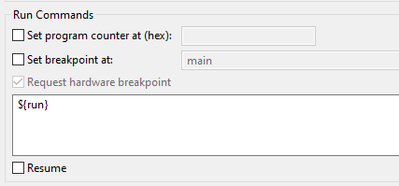

I'm not sure that this is exactly my scenario. Here would be my steps to reproduce this behavior:
  1. Disconnect the board completely from the host, reboot the host, and open MCUXpresso.
  2. Connect only the DAPLink / SDA port from the board to the host.
  3. Press the Debug button in MCUXpresso and wait for the program to load.
  4. Press the Continue button. (I tried disabling the "break at main()" feature by going to Project Settings -> Run/Debug Settings -> Edit... -> Startup and disabling "Set breakpoint at: main" and enabling "Resume" but this did not prevent MCUXpresso from still breaking at main() – any ideas?)
  5. With the sample code now running, but the device USB port having not yet been attached to the host, attach the port now.
Expected behavior: Since the host is seeing the device for the first time and no interruptions occur in program flow after the device is first attached, the device should enumerate normally.
Actual behavior: No device is seen by the host.
Maybe I am missing something in my mental model of how this is supposed to work? Corrections would be very welcome!

Ok, thanks for the details what you are trying to do. I was assuming that you want to debug the USB stack, while running, and this is what I was referring to.
Your use case works on my side (K22FX, J-Link and LinkServer) with the USB (CDC) stack:
a) run the debugger, target running
b) plug in USB cable to the host
c) device enumerates properly on the host
I'm using IDE 11.4.1, if that matters.
The other thought I have: check your power supply to the board, as a brown-out could affect debugging too.
