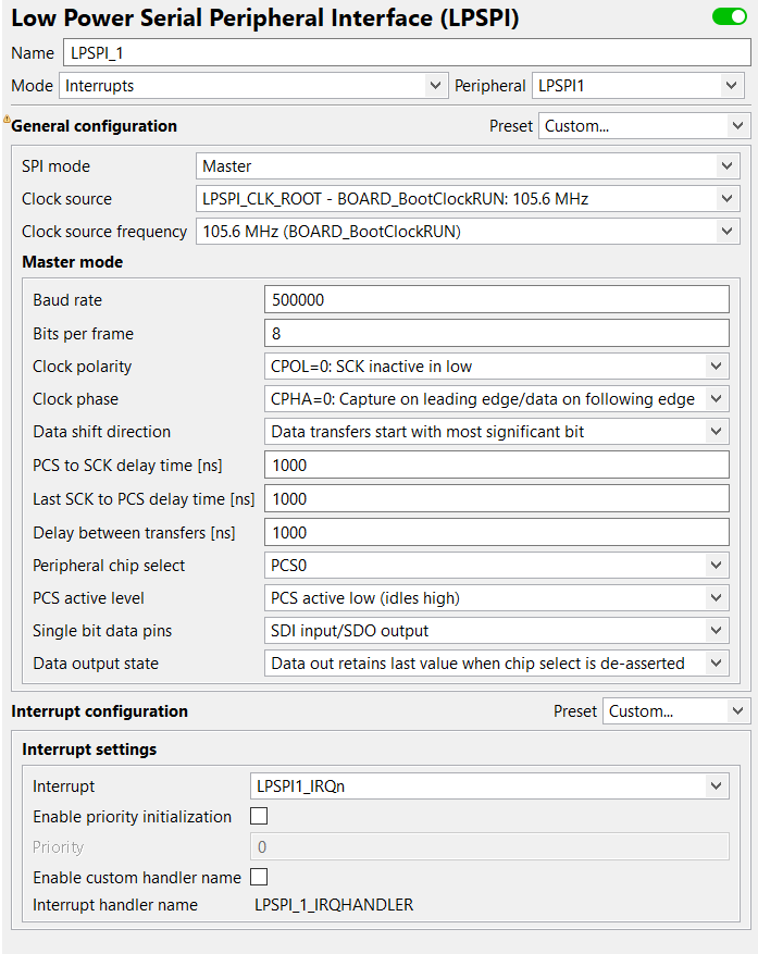

We are working with the SDK_2.6.2 version for MIMXRT1062xxxxA processor on a MIMXRT1060-EVK and I have a few questions regarding the available configuration modes for peripherals inside MCUXpresso Config Tools.
For example, each instance of the LPSPI peripheral has 5 user configurable modes (Polling, Interrupts, Transfer, eDMA and FreeRTOS). I have understood from the API Reference Manual that the Polling mode requires the use of the transfer blocking functions, while an Interrupt mode uses a non blocking data transfer.
However, when using a TransferNonBlocking function, the structure named handle, passed as a second parameter to the function, has fields which are configurable inside the Transfer tab only (e.g: Continuous PCS signal or Swap bytes option in case of a Slave instance). If in Interrupt mode, how can I change the default values for these fields inside MCUXpresso Config Tools?
Is the Transfer mode used only for a blocking type of data transfer? If not in Interrupt mode, the generated code in the peripherals.c file does not include the call of the EnableIRQ function.

Hui_Ma
Hi Razvan,
When you check MCUXpresso CT tool generated code with LPSPI interrupts mode, which using below LPSPI init functinon:
void LPSPI_1_init(void) {
LPSPI_MasterInit(LPSPI_1_PERIPHERAL, &LPSPI_1_config, LPSPI_1_CLOCK_FREQ);
/* Enable interrupt LPSPI1_IRQn request in the NVIC */
EnableIRQ(LPSPI_1_IRQN);
It just do the LPSPI initialization and enable LPSPI related IRQ at NVIC.
So, cusotmer also still need to call <fsl_lpspi.c> & <fsl_lpspi.h> driver to realise the data transfer.
Just as [lpspi_interrupt_b2b_master] demo showed, when using MCUXpresso CT generated interrupt mode code,
customer need to call below code to do data transfer:

constantinrazva
Hello Hui_Ma,
I think you misunderstood me - I am saying that you can use spi interrupt mode, but you don't have access to all settings for it, like enabling continuous mode. I am not sure what you wanted to show with the code snippets or with Daniel Chen's document - which I like, but does not help in clarifying the spi interrupt mode - continuous mode enabling problem.

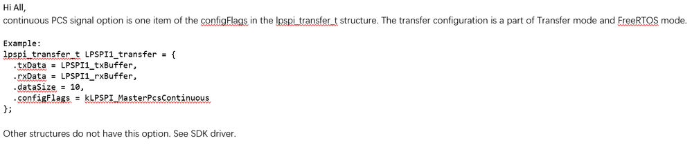

Hui_Ma
Hi Razvan,
I forward an email about this topic, you could check the feedback from MCUXpresso Config Tool design team. Thanks.
best regards,
