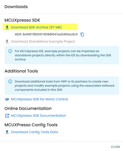

 Installing the SDK
The MCUXpresso SDK is complimentary and includes full source code under a permissive open-source license for all hardware abstraction and peripheral driver software. The Archive SDK can be installed using the MCUXpresso SDK Dashboard. Select the device and toolchain of preference you are working with. Download the zipped archive to continue. In this guide we'll focus on MCUXpresso IDE with the FRDM-MCXN236.

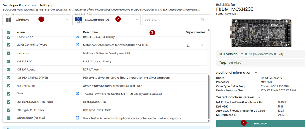

1. Choose your Operating System
2. Choose the toolchain
3. It is recommended to choose all of the middleware offered
4. Build SDK
Next your dashboard will appear with the Download option. Press Download, then click Download SDK Archive. Then agree to terms and conditions to download the zipped folder.
 This folder can be dragged and dropped to your MCUXpresso IDE "Installed SDKs" window.

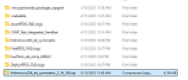

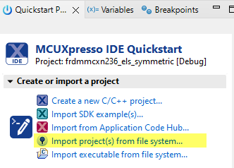

Importing application to workspace
Another scenario you may encounter, is if you already have an existing application from an older SDK but would like to import it to your current workspace with the updated SDK.

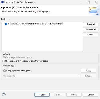

1. Go to QuickStart Panel and select Import project(s) from file system.
2. Browse your PC, for the zipped or unzipped application.
3. Click finish once your project has been selected.
Finally a warning will appear notifying that the SDK versions do not match and ask if you would like to make the new SDK persistent or not for this project. If the intention is to update to the new SDK and port over changes, then click OK. If not, then uncheck the option and continue.
Build and debug your application as normal.
Note: Updating the associated SDK does not mean that the files within your application will be changed automatically, this can be done manually by looking at the different sources you need in your application. You can also refresh the SDK components to update all the files withing your project (however not recommended as this will most likely cause conflicts, depending on the complexity of project). Adding drives using the SDK management tool, will inevitably grab the drivers from the latest SDK and prompt you to update other files that may have dependencies.

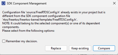

  7. If there is any existing file in your project that is marked to be updated. You will get a prompt that gives you the choice to replace, keep existing or check the difference. If in doubt keep existing(you can always go back and update later).

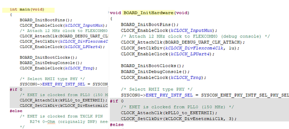

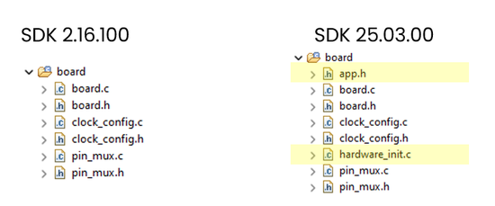

  4.  Next I review the Board folder as this will have custom board files. I know that the app.h and the hardware_init.c have a Board_InitHardware() function that does exactly what is in my main
  5. I know that the app.h and the hardware_init.c have a Board_HardwareInit() function that does exactly what is in my main. You can choose to replace the content in your main with Board_InitHardware or get rid of the files.
  6. I chose removing the files.

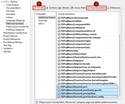

  7. Finally there is an additional folder in my old project which contains custom board files that contain information about the flash partitioning. That is used in the application source files. I copy the entire folder and paste it to the project.
  8. The folder will appear with out the blue icon, meaning that it is not yet included in paths the compiler will know where to look.

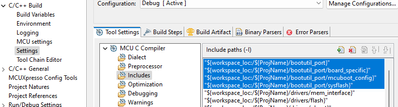

  9. Right-click the project and go to the properties. There are three locations that the folder and sub-folders need to be included.
  10. First under Settings -> Includes
  11. Next under Path and Symbols, in Includes and Source Location
  12. Now the folder will be ready.

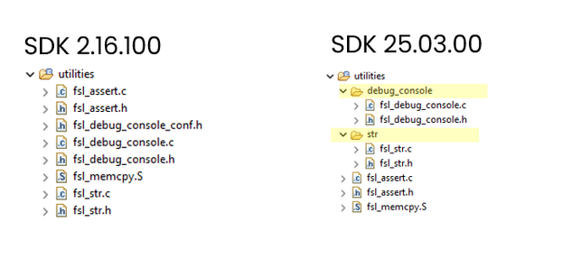

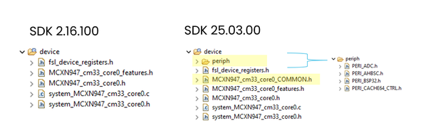

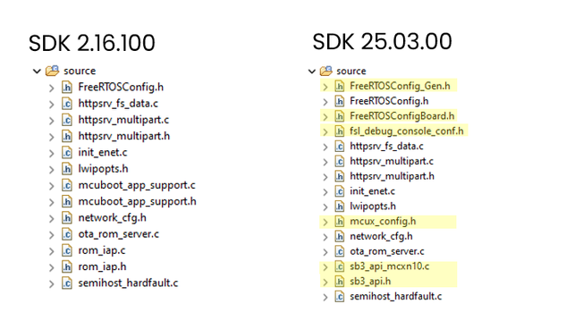

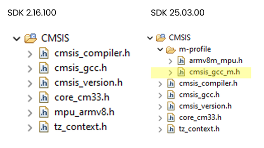

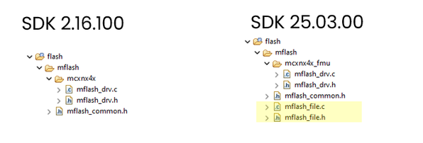

Exploring the project files
Let's look at the differences between an example from SDK 2.16.100 and SDK 25.03.00. In this project we are not looking at the content changes with individual drivers. That can be viewed in the changelog available in the SDK Documentation per SDK version.
The changes seen below are structure changes in the project and/or files that have been added or deleted.
CMSIS:
Board:

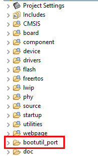

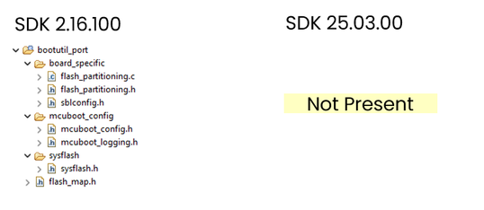

Boot Util Port:
Device:
Drivers:
Flash:
 Source:
  Utilities:
