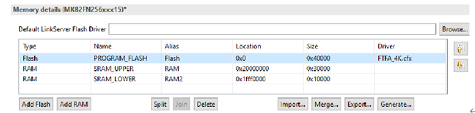

In this article, I will take FrdmK82f hello_world_freertos as an example to illustrate how to use FreeRTOS heap 5 memory scheme with MCUXpresso SDK. Like some other Kinetis MCUs, Frdmk82f has two memory controllers, one for the SRAM_UPPER (192k byters) and one or SRAM_Lower as below (64K byters).
 With FreeRTOS heap_4, application developers cannot have memory objects crossing that memory boundary 0x2000,000, they can only use SRAM_UPPER or SRAM_LOWER as FreeRTOS heap, with heap_5, they can combine SRAM_UPPER and SRAM_LOWER as a huge virtual FreeRTOS memory map.

For FrdmK82f, we can define two memory blocks, SRAM_UPPER and SRAM_LOWER. But SRAM_UPPER is the main RAM, it is not possible to allocate all the RAM to heap, leaving no RAM free for use by other variables. It is good to declare an array called ucHeap, it becomes part of the data allocated to RAM by linker.

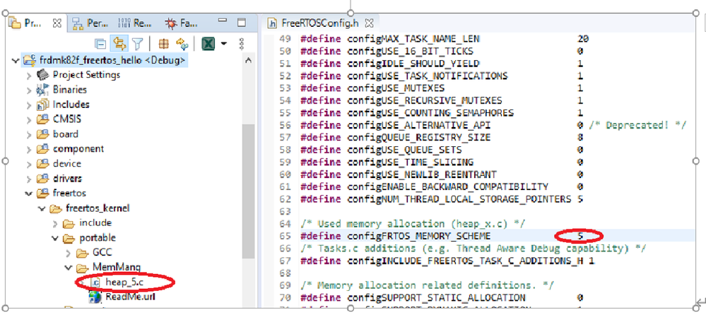

3    Configure FreeRTOS memory scheme
To use Scheme, make sure heap_5.c is used in the application as below picture shows.
ConfigFRTOS_MEMORY_SCHEME should be configured to ‘5’ in FreeRTOSConfig.h.
