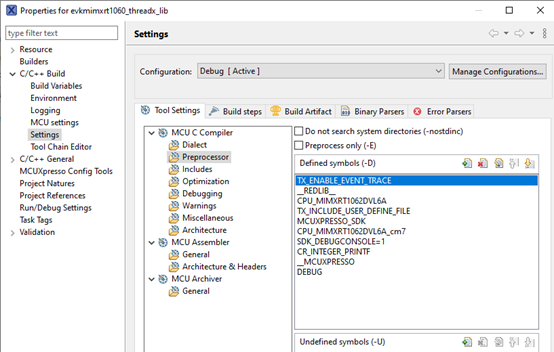

3.1 Add required preprocessor symbols
Trace-dependent code is activated using TX_ENABLE_EVENT_TRACE define. It must be added in the preprocessor section of the compiler. This must be done for the application itself and for the linked libraries. (e.g. ThreadX library)

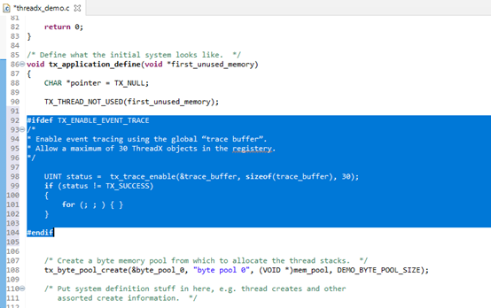

3.3 Enable trace
Trace must be explicitly enabled inside the application by calling tx_trace_enable(). This can be achieved by adding the below code.
 #ifdef TX_ENABLE_EVENT_TRACE
* Enable event tracing using the global “trace buffer”.
* Allow a maximum of 30 ThreadX objects in the registery.
UINT status =  tx_trace_enable(&trace_buffer, sizeof(trace_buffer), 30);
if (status != TX_SUCCESS)
    for (; ; ) { }
#endif
It is recommended to enable trace inside tx_application_define( ).

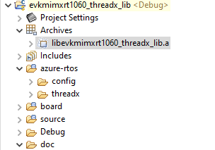

3.4 compile
Compile the ThreadX lib (the compiled library will be in the Debug folder).
After successful build and compilation, a new library appears in the Debug / Release directory. It has a name like libevkimixrt1060_threadx_lib.a.
Please rename it to libthreadx.a and copy it to the directory, azure-rtos/binary/treadx/mcux/, in the evkmimxrt1060_threadx_demo project to replace the original one.
Replace the libthreadx.a files in the threadx_demo project

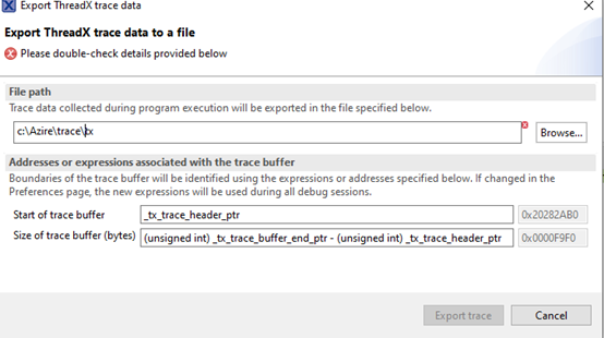

4 Exporting Trace

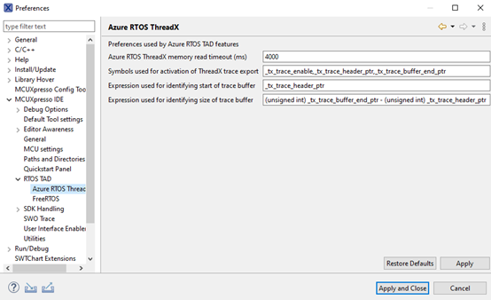

4.1 Configuration of Trace Export feature
Trace Export feature is controlled by a list of preferences that can be accessed and further modified via window->Preference page.

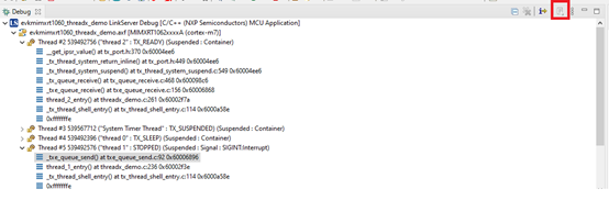

4.2 Trace Export button
Pause your application and the Trace Export button is located in the Debug view’s toolbar, as illustrated in the screenshot below.
4.3 Exporting Trace
Once the Trace Expert button is clicked, a modal dialog window will be presented.  A file path must be specified and then click the Export button. The exported file can be imported in Azure RTOS TraceX tool afterwards.

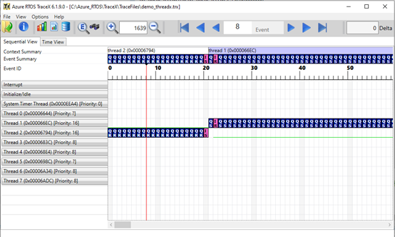

5 Display with Azure RTOS TraceX tool
From Azure RTOS TraceX, we can open the imported file.
System summary line contains a summary of the context as well as the corresponding event summary underneath.
Azure RTOS TraceX provides a built-in execution profile for all executed contexs

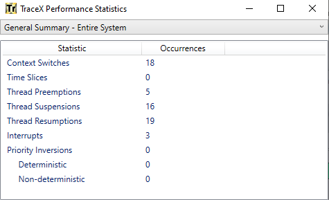

Azure RTOS TraceX provides a build in performance statistics report for the currently loaded trace file
