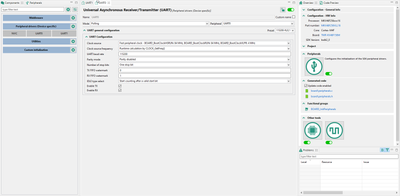

I'm running an example code called "uart_polling". I have changed the baud rate to 9600, and have let the other part of the code unchanged. I'm using putty to communicate with the board. According to the function, the following needs to be printed.
"Uart polling example\r\nBoard will send back received characters\r\n"
but I see nothing on the port. I have also checked the COM port config and it seems fine. I'm using the tower evaluation board - TWR-KV46F150M. Is there a need to change the jumper setting to get the uart value?
I have changed the UART pins to GPIOD7/TXD0 and GPIOD6/RXD0 and changed the jumper cable to connect pin 2 and 3 on both J505 and J506. Yet, I don't see any value on the putty.
Where am I going wrong? Help me out.

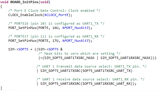

Hi, @Alexis_A There was some jumper setting issue. When I rebooted the program it worked fine for me. So, I went ahead to make the changes to the pin setting. Instead of using the PTE0 and PTE1, I'm using PTE16 and PTE17 since both are uart1 tx and rx pins. Apart from this change, I haven't touched the example code. But now, with this new settings, I'm not able to see any output.
Is it mandatory that I need to use only PTE0 and PTE1 pins?
Further, I created a new program and tried recreating the same program with  PTE0 and PTE1 pins using config tools. But I'm not able to access that pin. Only UART0 is available. Why is that?

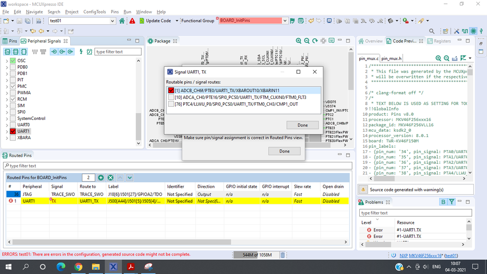

soaring_sun
Hi @Alexis_A
I have attached the pictures where I'm having problems. It has not yet been resolved for me.Screenshot (22).pngScreenshot (22).png
It states: There are errors in the configuration, generated source code might not be completed.
Any pin that is connected to UART1 shows this error when configured. UART0 works fine for me. Why not UART1?

Alexis_A
Hello @soaring_sun,
That's strange, I didn't see this error while configuring the UART peripheral. Could you try updating the IDE to the latest version (11.3.0)?

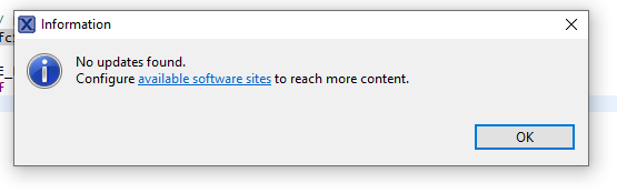

soaring_sun
Hi @Alexis_A
I have tried to update and install the newest software IDE, but the site says that there are no new updates. Yet, I have updated the available software just to be sure. But I still have the same problem.

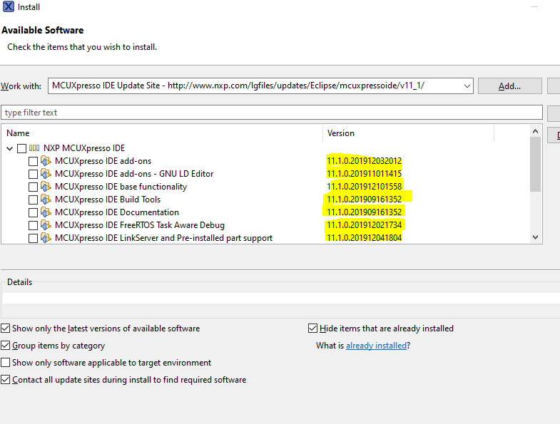

I have followed the following steps for new installation.
help -> install new software -> selected MCUXpresso IDE update site
But all the versions are 11.1

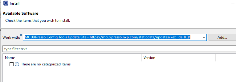

I have also tried to update the config tools following the same path.
help -> install new software -> MCUXPresso Config Tools
But there are no updates.available
When I choose check for updates, this is what is says.
Right now, I'm running my IDE with a version of 11.2.1. And this hasn't solved my usage of UART1

converse
Senior Contributor V
You cannot update the IDE. You have to download and install the latest version (which is v11.3). The update mechanism is only used for patches, not new versions.
