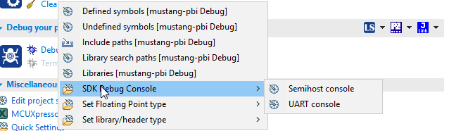

  2. Change the configuration from Quickstart Panel -> Miscellaneous -> Quick Settings>>

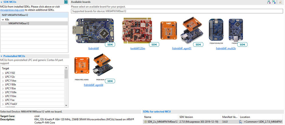

Step 1 – Create a new project from MCUXpresso Quick Panel
Step 2 - Choose right SDK software components

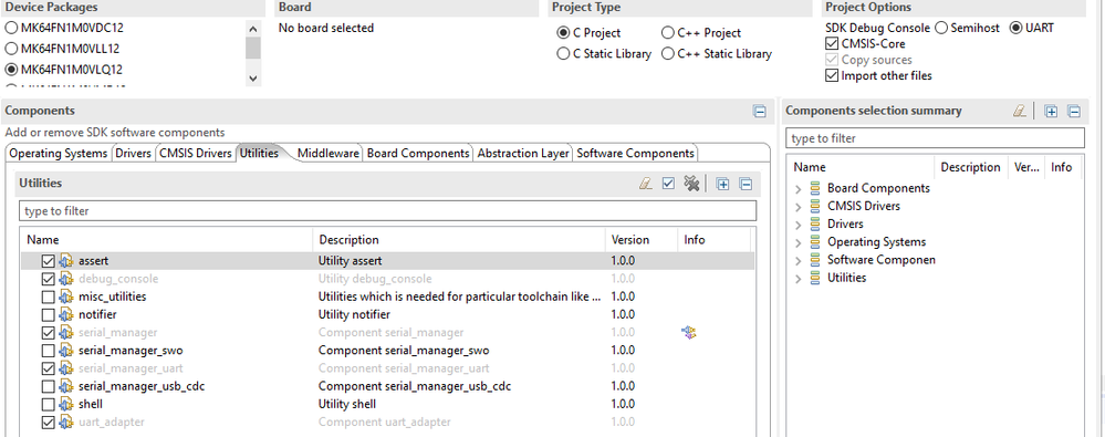

In my case, since I just use UART for connecting to Tera Term VT100 screen, so I simply do:
1. Select FreeRTOS
2. Select all Drivers
3. Select all CMSIS Drivers
4. On Utilities, I have done two ways:
(1). Select none
(2). Select Serial manager shown above

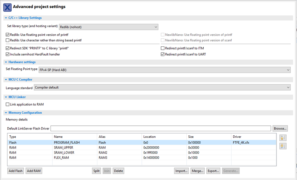

Step 3 - Advanced configurations (tried multi cases, got the same result)
case 1: use Redlib (nohost)
case 2: use NewlibNano (nohost)

It is confusing that the UART is not selected as I have done so in Step 2, but it can be reconfigured.
I checked the configuration from Quicksettings, and it is correct here.

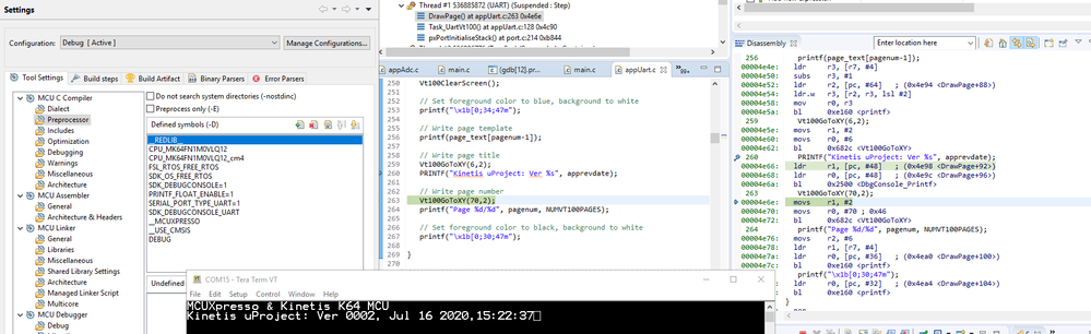

Result: printf() did not send anything to the UART (without set SERIAL_PORT_TYPE_UART=1).
"MCUXpresso & Kinetis K64 MCU" shown in the console captured in the screenshot below is done by UART_WriteBlocking() for checking UART configuration.
Step 6 - Modify Preprocessor by adding SERIAL_PORT_TYPE_UART=1, and run the project and see the same result
Result is the same.

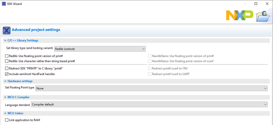

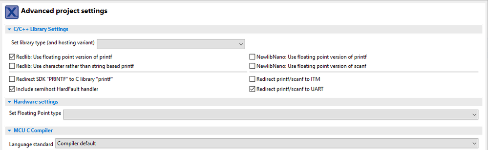

4. Instead of selecting proper Utilities, I went to next:  Advanced project settings first:
As can been from screenshot below, you are able to check pastedImage_9.pngwithout checking pastedImage_10.png, I checked pastedImage_11.pngas well since I need to use floating point version of printf (this can be done later in Quick Settings).
After that I go back to select Utilities:
Then, click Finish to create the new project.
In Settings ->Preprocessor, you should see the settings as below (If you see CR_INTEGER_PRINTF, remove it for floating point)
Then, you should be able to use all standard library functions in your application.

Hello zhiqunhu,
I'm trying to do the same initialization but I stuck at "Advanced project settings". I use MCUXpresso IDE v11.5.0 with 2.11.0 SDK Version (MK64FN1M0xxx12). I can't select 'Redirect print/scanf to UART' (it's not active) without checking 'Redirect SDK "PRINTF" to C library "printf"'. It would be nice to have possibility to use standard printf. I tried to set different library types and hosting variants but it didn't help.
Do you have some idea? Did I miss come setting?

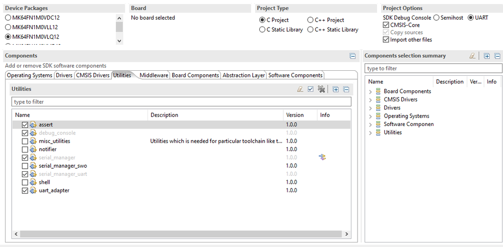

The way to make PRINTF() work is to follow configurations below:
1. Step 1 is the same as that in previous post.
2. Step 2 Configure the project:
(1). Select RTOS, Drivers and CMSIS Drivers the same way as previous post.
(2). Select Utilities as the screenshot below:
Please note to select uart_adapter, otherwise you will get the error like this of missing uart.h file:

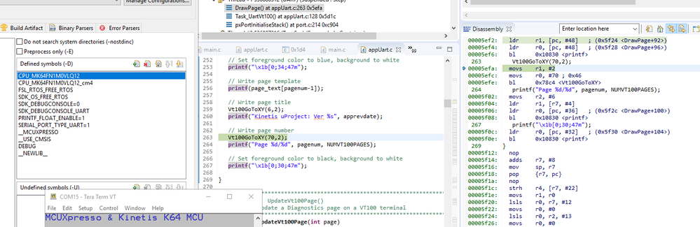

Step 3 - Advanced project settings
To check on Redirect printf/scanf to UART, you have to check at Redirect SDK "PRINTF" to C library "printf"

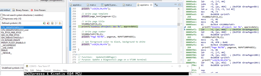

If you check SDK Debug Console from QuickSettings, you will see UART is not selected. And if you take a look at the Preprocessor, you will see SDK_DEBUGCONSOLE=0.
I ran the project and got:
From assemble code, you can see PRINTF() is still using printf(), so that is why there is nothing to UART.
So you need to modify SDK_DEBUGCONSOLE=1, then build/run again and as can be seen from assembly code, right now PRINTF calls DbgConsole_Print(), so the string "Kinetis uProject: Ver" come to Tera Term console via UART.
