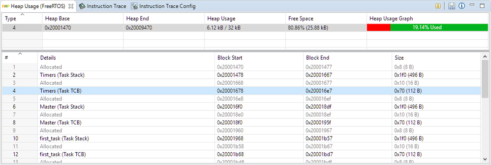

josephjean-jacq
Is there any particular way to determine how much memory xTaskCreate() uses for each call or is that answer given by the stacksize you pass as a argument in the function call?
11,960 Views
BlackNight
Yes, that's mostly given by the amount of stack you specify for the task size. Keep in myind that the number is in 'stack units' so for an ARM as 32bit machine for 1024 it it is 4x1024 bytes. In addition each task needs space for a TCB (Task Control Block).
You can see the task stacks in the Tasks view:
There is an article about FreeRTOS stacks here: Understanding FreeRTOS Task Stack Usage and Kernel Awareness Information | MCU on Eclipse
In the Heap view you have the information about the memory allocated (if using dynamic memory):
I hope this helps,
Erich

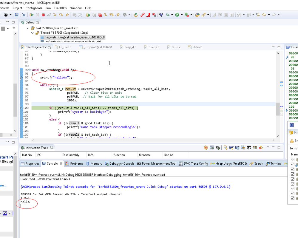

josephjean-jacq
I am using the Kinetis K65 MCU.
Here is the code (which I got from youtube) that I'm trying to run. It is an example on using event groups with a software watchdog.
I noticed printf calls works in good_task and bad_task functions, but not in the sw_watchdog function. That is the only function I can't get printf to work normally.
I also tried your suggestion: Quickstart Panel -> Quick Settings  -> SDK debug console -> Semihost console , but to no avail (I also made sure the Event_Groups project was selected before trying the above approach).

Hello   Joseph Jean-Jacques,
It seems your project haven't run into the task of  "sw_watchdog", what about on your side?
Set a breakpoint on it to have a test . After delete the other tasks , only leave "sw_watchdog"(to make sure run into this task), the printf can print "hello" on Console view :
