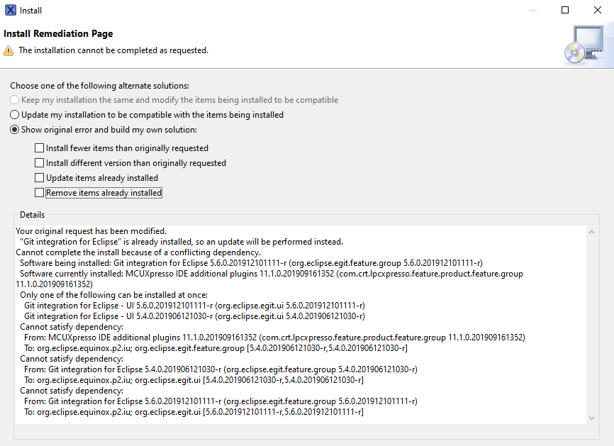

I'm experimenting troubles using git inside MCUXpresso 11.1.0.
If a git-versioned project is present in the workspace, then whenever a team sharing is attempted or git settings are accessed (Window -> Preferences -> Team -> Git -> Configuration), the IDE hangs and a forced close is required.
The same happens also when importing git-versioned projects with "Auto share git projects" enabled or when trying to open the project.
No problems on MCUXpresso 11.0.0.
Git version is 2.25.0.windows.1

Same for me, not critical, but annoying, I can commit, but pushing will stall eclipse tasks. I need to do git push with command line.
Also, eGit update is not allowed by an eclipse dependency problem.

This sounds like the issue described at :
Does installing a newer version of EGit help?

Sounds like - I already found something similar, but I'm not so deep into Eclipse to hack it.

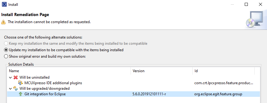

EGit version released with MCUXpresso IDE 5.4.0.201906121030-r and apparently it is not possible to install release 5.6.0 because of a dependency issue:
Of course we don't want to uninstall "MCUXpresso IDE additional plugins"! That turns out to be com.crt.lpcxpresso.feature.product.feature.group:
The singificant lines are:
Cannot satisfy dependency:
From: MCUXpresso IDE additional plugins 11.1.0.201909161352 (com.crt.lpcxpresso.feature.product.feature.group 11.1.0.201909161352)
To: org.eclipse.equinox.p2.iu; org.eclipse.egit.feature.group [5.4.0.201906121030-r,5.4.0.201906121030-r]
I googled a bit, but I can't find a workaround so far.
