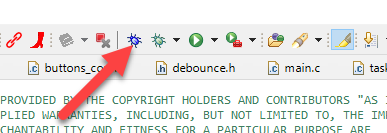

Did you use the 'blue' debug icon?
It seems to me that you tried to launch it as an executable on the host?
I hope this helps,

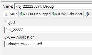

Can you check/share your launch configuration settings? The path to the binary is specified here:

Frogram
I tried to move file location to hardware drive, not onedrive
also it's mine

Why is there such strange path separation symbol?
never seen something like that.
It should be a '/' or '\'
