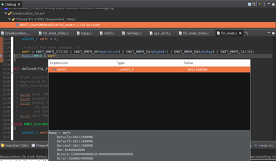

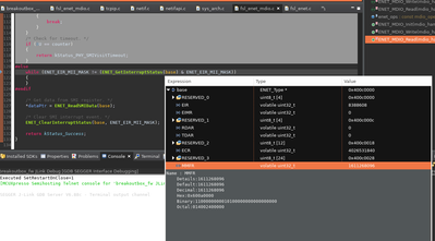

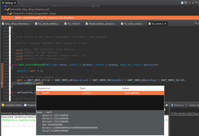

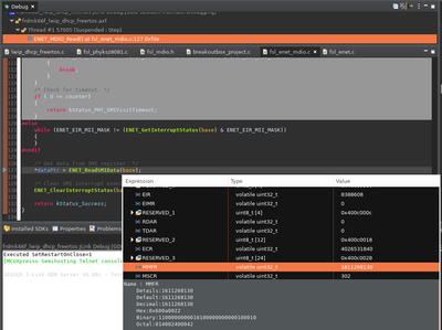

Debbuging my project I found that the code fails here:
//File:fsl_phyksz8081.c
    /* Check PHY ID. */
    do
        result = MDIO_Read(handle->mdioHandle, handle->phyAddr, PHY_ID1_REG, &regValue);
        if (result != kStatus_Success)
            return result;
        counter--;
    } while ((regValue != PHY_CONTROL_ID1) && (counter != 0U));
    if (counter == 0U)
        return kStatus_Fail;
The variable regValue aways had 0x00.
On the example project the regValue had 0x22
--- UPDATE ---
A very strange thing happen, when it reads the current regValue it was 0x00 on example:
regVallue are the last signaficative bits of mmfr
But when the function returns it had 0x22:
The same didn't happen on my project:
Somebody can help me?

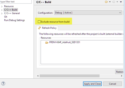

Hi alfredos:
Just an information: when you copy another folder into your MCUXpresso project, the default behavior is: this folder will be excluded from build. you need to uncheck "exclude resource from build".
