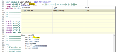

I am seeing wrong values for nearly all constant variables in MCUXpresso. It shows the wrong value when I add the variable to a watch expression or if I hover over the value. It seems all uint16_t variables show the same value of 0x3000. I set the constant variable to another constant uint16_t pointer and that seemed to fix the issue for that specific constant variable.
Optimization is disabled.
Is this a known issue? Is there anything I can do on my end that would fix this issue?

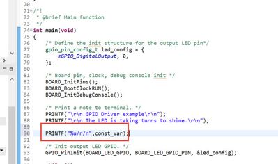

Hello @nick_schneider
Thanks for your sharing. I checked it on my end. This is an issue with the IDE Expression view. There is no issue with the real value. You can use PRINTF() to print it out as follows.
Feel free to contact me if still have issue.
