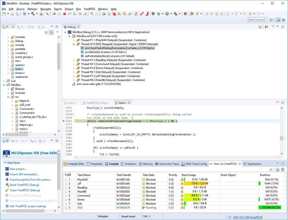

bartosznogalski
just encountered the same problem. After some research it appeared that its ulTotalRunTime that is being removed and not FreeRTOSDebugConfig as was mentioned. Marking ulTotalRunTime with __attribute__((used)) in tasks.c solved the problem. In case i also marked other variables being used for runtime stats: ulTaskSwitchedInTime, ulRunTimeCounter. Hope someone will find it useful.
6,885 Views
BlackNight
For the FreeRTOS thread awareness, there are as well several symbols which need to be present and not optimized. Details in Troubleshooting Tips for FreeRTOS Thread Aware Debugging in Eclipse | MCU on Eclipse
I hope this helps,
Erich

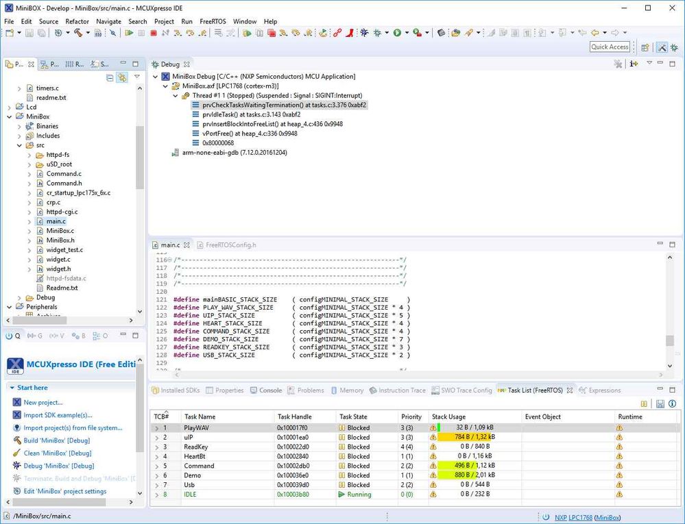

giovanniquaglia
Hi Erich,
I tried your workaround and error goes away. Almost everything works, this il the situation :
remains two esclamation point tooltips (see below).
If I choose optimize code O0 for FreeRTOS ...
only stack tooltip remain.
Many tanks for support, but I hope this help to make MCUXpresso more smart.
Giovanni

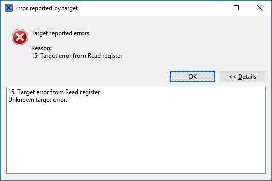

giovanniquaglia
Hi Erich,
tank you for support.
If I include in main() reference to FreeRTOSDebugConfig as below
 if (FreeRTOSDebugConfig[0]==0) //just use it, so the linker cannot remove FreeRTOSDebugConfig[]
 {         // FreeRTOSDebugConfig[0] should always be non-zero, so this should never happen
  for( ;; );
at first breakpoint or debug stop MCUXpresso display
and FreeRTOS TAD does not work.
Giovanni
6,885 Views
BlackNight
Hi Giovanni,
Indeed, I was running into the same thing. But I have a workaround for you:
1.Close the IDE
2. go into <mcuxpresso>\ide\bin and rename crt_emu_cm_redlink.exe to something like crt_emu_cm_redlink_original.exe so you have a backup.
3. unzip and place the attached patched binary into the above folder.
At least on my machine (Windows 10, 64bit) this solved the issue. Can you try this on your end?
I hope this helps,
Erich

This is screen with code opt O3
This is screen with code opt O0
If you need anymore information please ask me.
