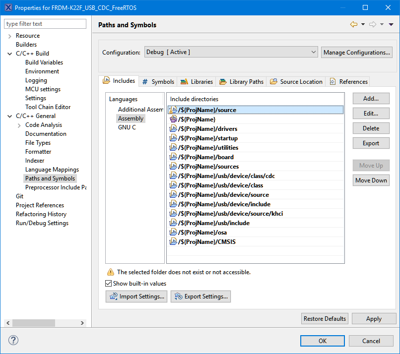

I'm trying to make the switch to MCUXpresso (mostly from CW 10.7, but with a few KDS projects) and some of the screen layout issues are driving me nuts.  Here's an example:
The lower half of the pane is all scrunched over and half invisible, and I can't seem to do anything to resize it.  Does it show up this way for everyone, or is this something that happened when I changed themes?  Changing back doesn't fix it.  The annoying tiny scroll bars might be a theme issue, but that sounds like it's fixable.

Hi Scott,
I have never seen something like this you are showing in your screenshot.
This is how it should look:
I'm wondering what is causing this strange arrangement on your end. I know that some rather exotic graphic cards/chips and drivers have caused issues, so maybe this could be a reason. One of my students had some UI elements not shown poperly, and the reason was an outdated BIOS (well, probably that was not the cause) and outdated/buggy display drives for his notebook graphic controller. Can you check that it is not that problem for you?
As you see similar things in KDS, this let me believe it is something on your machine and outside of Eclipse causing what you see.

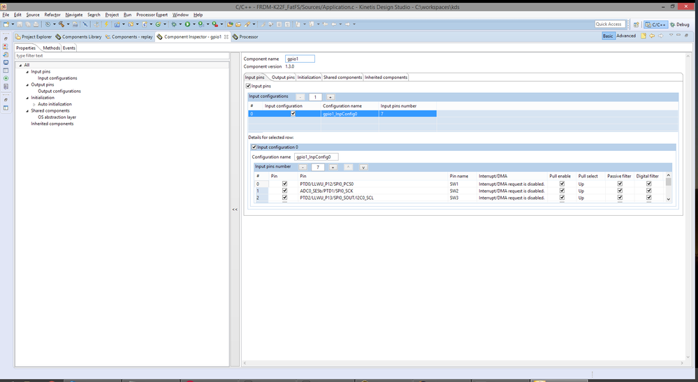

KDS's layout isn't glitchy, exactly, it's just like it wasn't very well thought out:
You can fit a whopping 3 I/O pins on the screen at a time, no matter how much space you have - it just doesn't resize, and you have to scroll around to see anything. It's like coding while looking through a drinking straw. There's no need for it, and it makes it feel like the tools were designed by people who never had to use them on a daily basis.

BlackNight
Hi Scott,
about the 3 I/O pins view: I recommend to use the classic 'no-tabs' view as it is much better imho: Switching between ‘tabs’ and ‘no-tabs’ UI in Processor Expert | MCU on Eclipse

scottm
Senior Contributor II
Ah, I had no idea that was an option!  That's much better.  I'll have to add that to the tally of beers I owe you.  :smileywink:
