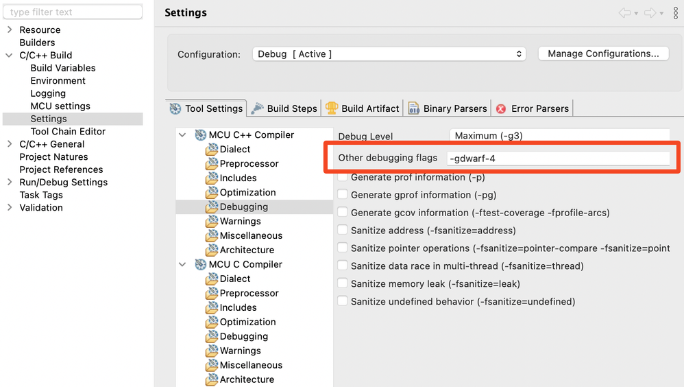

Building headless (via CDT's generic org.eclipse.cdt.managedbuilder.core.headlessbuild application) or opening a project's properties in the GUI adds the -gdwarf-4 option to the com.crt.advproject.gcc.lib.release.option.debugging.other setting of the currently active configuration in library projects.
While this setting also seems to be the default for executables, it does not get re-added there and I am not sure if it has the same effects when linking as with libraries. But with static libraries the resulting binaries are actually different as the debug info gets embedded into the object files that end up in the library, which is obviously unwanted.

I have this issue as well.
On Mac OS Sonoma Version 14.2.1 with MCUXpresso IDE v11.9.0 [Build 2144] [2024-01-05] and MCUXpresso SDK Version 2.15.00 (801 2024-01-15) for MIMXRT1060-EVKB.
Any new SDK Example project has the -gdwarf-4 debug option set in the IDE even though this flag is not specified in the config of the example (XML) or in the .cproject file.

Indeed, the IDE changes the implicit Dwarf format used by GCC. As you noticed, Dwarf 4 is now used instead of the default Dwarf 5. Long story short, this should not affect the actual code that's being generated, only the debug information is affected. We decided to enforce Dwarf 4 for debugging purposes, because of the many issues we've encountered with GDB, not being able to fully interpret Dwarf 5 (for now). If you want, you can always specify "-gdwarf-5" in the "Other debugging flags" field and the IDE will not change it in this case.

The problem is that this actually enforces debug information to be present in the binary (no matter what the other "Debug level" is set to), which is undesired in our case. Software overriding developers is never a good idea. A warning would be more appropriate IMHO. Checking the "Debug level" for non-"none" before setting the value would also improve things (for my case at least).
