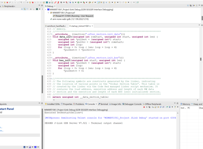

I had a code base ported from Keil. I am unable to flash the target or debug the code.
When I first start the debug session, I get to choose the debugger

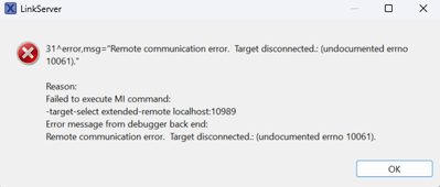

Choosing the first one, the MCU-Link gives me the following error windows:
and

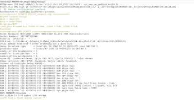

Following is the log I get in the console:
When I select Segger, it seems to open the debug perspective, but then nothing happens. I am not able to run or step through the code
The target is iMX-RT1061

Hi @Vivek_MT ,
Thanks for your interest in NXP MIMXRT series!
Can you send a copy of the minimum project? So that we can reproduce your issue locally. This helps us to quickly locate and move forward. Thanks in advance.
