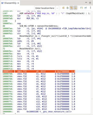

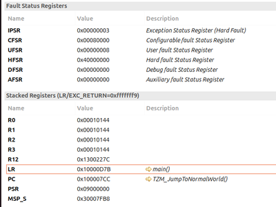

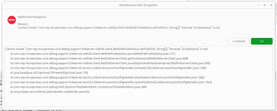

If I press the "Update Code" option—due to a pin/timer/secure area modification or even without making any changes—the previously working application begins to show errors when I try to debug. Initially, it gives a null pointer error, and if I try to run the program, I encounter a hard fault, as shown in the example images.

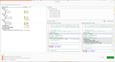

If I add the projects using the "import SDK examples" option and then build and run them directly, I encounter no issues, and the project functions as expected. However, the problem arises when I use the "update code" option. As seen, there are many warnings in the default code state.
The key point here is that the issue only appears when the TrustZone codes are updated. If I don’t update the TrustZone codes, I don't encounter this issue. Additionally, if I open any other project containing TrustZone, I continue to receive this error. So, the problem seems to be in the code generation for TrustZone.
When I look into the source of the error, I see an issue related to floating points. When I check my UFSR register, as shown in the first image, I notice that the NCOP flag is set. The hard fault occurs during a floating-point operation. Could there be an error related to hardware activation for floating points in the new version of TrustZone?

Making some test I notice that there is a conflict on the versions of config tool and the example. This occasioning changes in the code regardless of whether you modify anything.
I recommend you make the modifications to the example through code.
