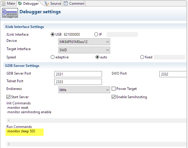

What you might try is to use the monitor sleep command (see Workaround for “Error in final launch sequence: Cannot execute this command without a live selected ... ):
Maybe this helps?
