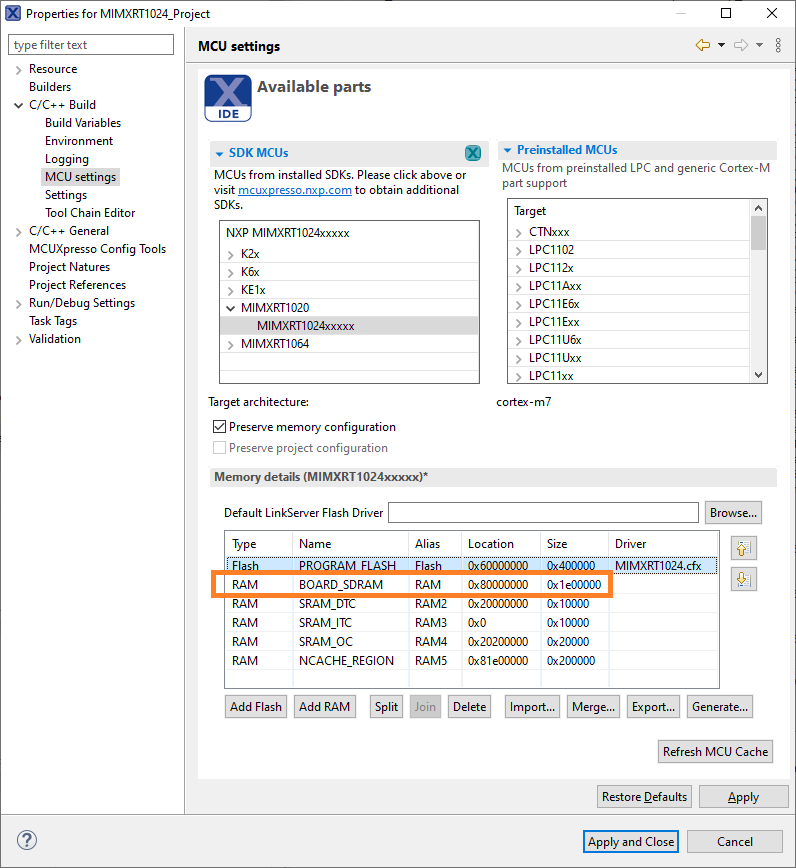

I'm using a MIMXRT1024-EVK board, MCUXpresso 11.5.0 and SDK 2.11.0.
I'm trying to use this device in various cases, I've successfully compiled and debugged a project running both in flash and internal ram.
Now I'm trying to do the same thing in external SDRAM, but with no success.
I've modified the project settings:
The project is correctly built and linked to SDRAM:

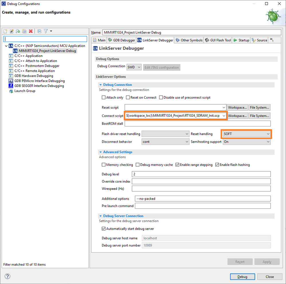

Based on this post, I've modified the lunch configuration settings:
The RT1024_SDRAM_Init.scp attached file is modified compared to RT1050_Debug_Connect.scp file referred in the post due to different registers addresses.

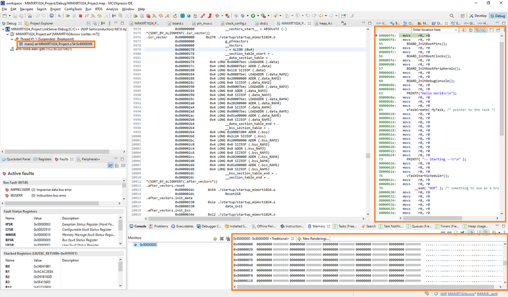

When I start to debug the project I can see that it refers to SDRAM (the current location is at 0x800005F6), but all the SDRAM content is 0 and I can't even modify it.
From the console debug messages it seems that the program isn't downloaded:

Starting execution using soft reset with PC 0x0 SP 0x0 from load at 0x80000000
Stopped: Breakpoint #1
What am I missing to debug a program in SDRAM?

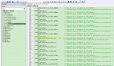

I've found the cause. In the RT1050_Debug_Connect.scp the configuration for the DQS pin is done using the SION bit (unlike all the other pins), setting the register value to 0x10.
In the RT1050 device the configuration register for the DQS pin is on the register IOMUXC_SW_MUX_CTL_PAD_GPIO_EMC_39 at the address 0x401F80B0.
In the RT1024 device the configuration register for the DQS pin is on the register IOMUXC_SW_MUX_CTL_PAD_GPIO_EMC_28 at the address 0x401F8084.
With the correct settings, I can debug fine in SDRAM.

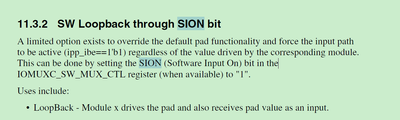

Now this is my question: why is it needed to set the configuration register for the DQS to the value 0x10, unlike all the other SDRAM pins, for which the value 0x0 is used?

  You mean this one:
IOMUXC_SetPinMux(
IOMUXC_GPIO_EMC_28_SEMC_DQS, /* GPIO_EMC_28 is configured as SEMC_DQS */
1U); /* Software Input On Field: Force input path of pad GPIO_EMC_28 */
static inline void IOMUXC_SetPinMux(uint32_t muxRegister,
uint32_t muxMode,
uint32_t inputRegister,
uint32_t inputDaisy,
uint32_t configRegister,
uint32_t inputOnfield)
*((volatile uint32_t *)muxRegister) =
IOMUXC_SW_MUX_CTL_PAD_MUX_MODE(muxMode) | IOMUXC_SW_MUX_CTL_PAD_SION(inputOnfield);
if (inputRegister != 0UL)
*((volatile uint32_t *)inputRegister) = inputDaisy;
The inputOnfield set as 1 in IOMUXC_SW_MUX_CTL_PAD_SION, right?
This will force input path of pad GPIO_EMC_28.
In fact, in the SDK code, it also set it.
Wish it helps you!

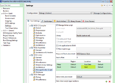

  Please check these points:
1. XIP_BOOT_HEADER_DCD_ENABLE=1
2. stack location modify from end to start
Then test it again.
Please try it on your side.
If you still have issues about it, please kindly let me know.
