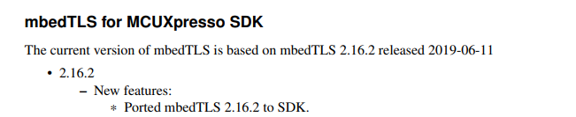

What version of TLS is in the mbedTLS version that comes with the latest MCUXpresso SDK (in my case for RT1020/RT1050) please?
Is it always the latest mbedTLS provided by ARM, e.g. currently TLS 1.2?
Thanks.

Hope you are doing well. To check the middleware versions of our SDKs, please check the change log that can be found in the SDK builder on the bottom right corner in documentation.
Here you will find that the mbedTLS version is as follows:
Hope this helps.
