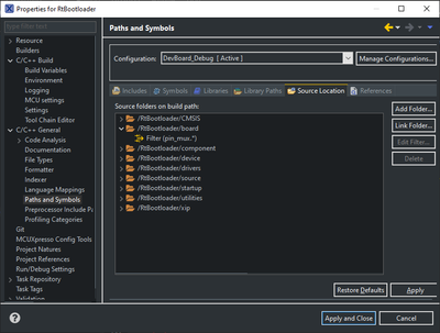

I currently have a project that pulls from other projects depending on the build configuration.  I thought that I had it working, but it seems to "remember" files and randomly pull from the projects.
Example:
I have my primary project that is specific to a design and will eventually have a custom board.  In a second project, I have stripped out everything except the pin_mux files so I can work with the dev board until the custom board is delivered.  Additionally, I have a common project that contains more generalized files and I'm treating it as a library.  In the primary project, I have added/renamed the build configurations such that I have a DevBoard_Debug, a ProjectSpecific_Debug, and Release.  For now, I'm simply trying to use the DevBoard_Debug to point to the secondary project "board" folder to pull the pin_mux files; I removed the reference to the primary "board" folder from the include folder.  However, as I walk through the code, I see files from the primary project "board" folder, the secondary project "board" folder, and the library "board" folder.

After studying the above links and some experimentation, I came across a possible solution that seems to work well in my situation; I added controlled filters to the source location.  The filters appear to be specific to my build configurations and this works really well with a sample size of 1.  Not sure if this is useful to other people, but thought I'd at least share.

chadgraham
Contributor V
Hi Myke,
The filters I'm using are part of the Source Location tab.
For me, it was enough to  filter out the pin_mux files so the compiler didn't see them and it looked in the other folder.  In the ProjectSpecific and Release build configurations, I didn't add the secondary project to the include list and I didn't need to add the filter.
