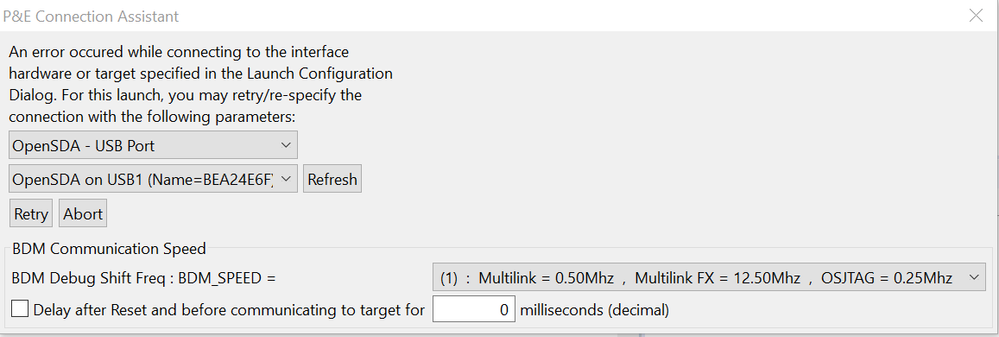

hedj
When I tried to debug my app using MCUXpresso IDE, I have this error.
My board is MK22FN512VLH12.
In my device manager, I can see a "OpenSDA CDC serial port".
Can anyone tell me what went wrong?

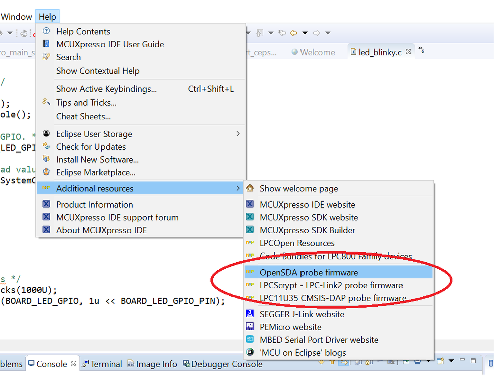

lpcxpresso_supp
Some older Kinetis boards ship appear to ship with OpenSDA firmware supporting P&E VCOM but with no actual debug support. I suspect that this is what you have.
To update this firmware, please visit the OpenSDA Firmware Update pages linked to within the IDE menu:
  • Help -> Additional Resources -> OpenSDA Firmware Updates
MCUXpresso IDE Support

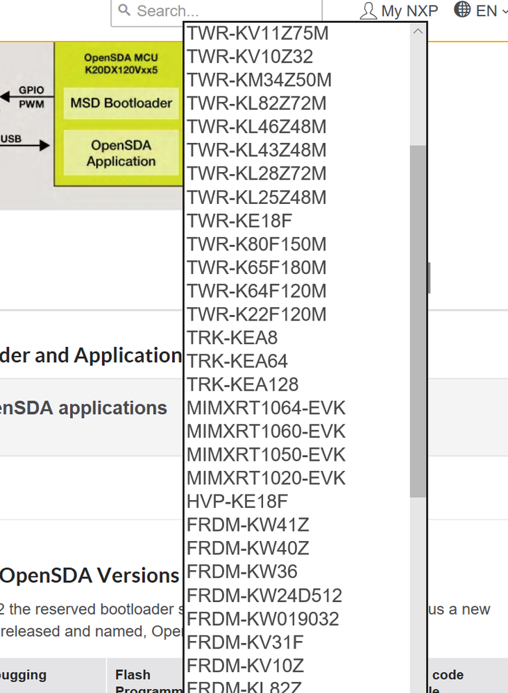

hedj
My IDE (v11.0.1 [Build 2563] [2019-09-01]) shows me the above choices.
By clicking "OpenSDA probe firmware", I was redirected to a web page "OpenSDA Serial and Debug Adapter | NXP ". But I cannot find my board in the drop down list.

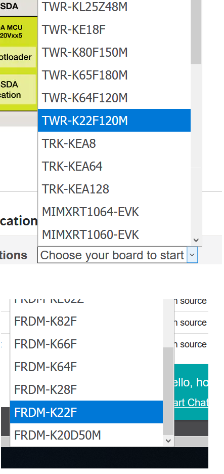

jingpan
K22 please use TWR-K22F120 or FRDM-K22F.
Jing

hedj
Now when I connect the board to my computer through USB, what I get is a "maintenance" drive; however I don't get COM port; and I still cannot debug with MCUxpresso.
In the drive, there are two files: details.txt and help_faq.html.

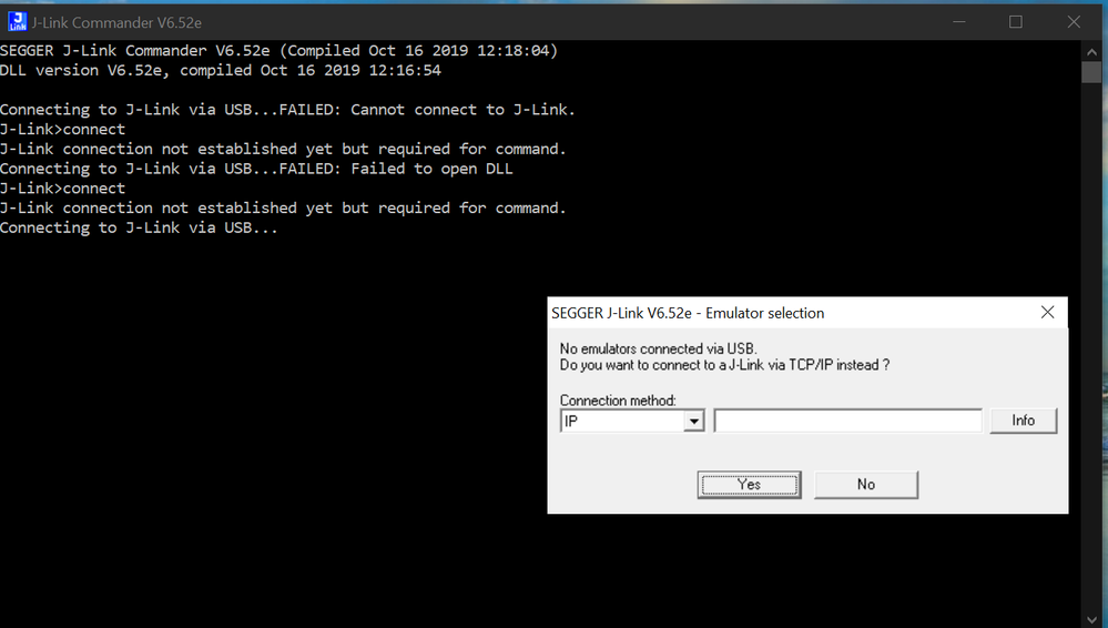

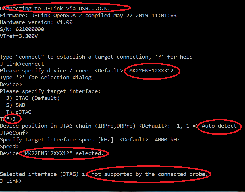

hedj
when I run J-Link command, I was prompted with this:
what is the IP address I shall put in?
9,663 Views

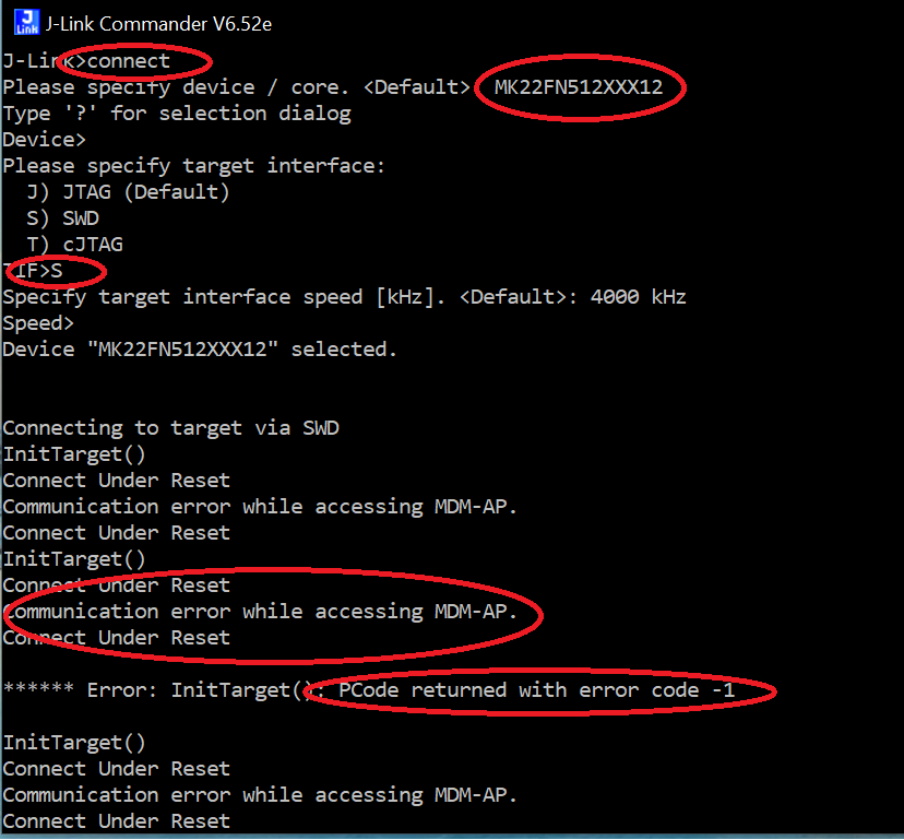

hedj
I also ran into this:
Is there something wrong with my board?
9,663 Views
converse
Senior Contributor V
Mk22 (and any other Cortex-M device) does not support JTAG. You must use SWD instead.
9,663 Views

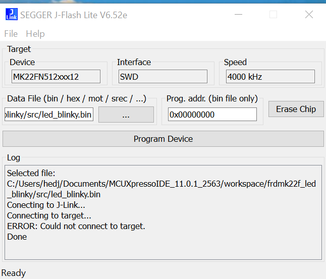

hedj
SWD also failed
9,663 Views
jingpan
This is maybe a hardware issue or the chip is locked. Please refer to below link
Communication error while accessing MDM-AP.
If everything fails - the soldering iron is only option.
Jing
