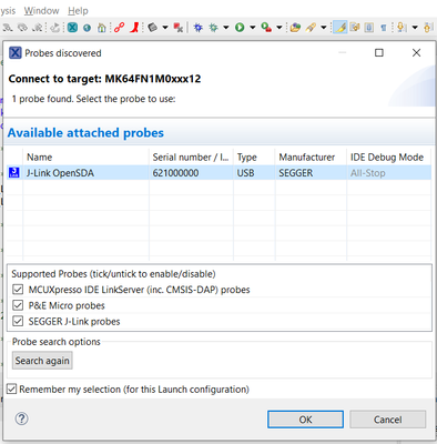

I imported Blinky_LED code from example projects in MCU X presso IDE and compiled without error and loading in to Frdmk-64F development board, it is not loading showing the not able to detect target and some time error from debugger end:
connections are line : 1 USB cable connected from J26.
Debugger settings in tool : J link interface USB : 123456
                                           Device : MK64FN1M0xxx12
                                            Target Interface : SWD
                                            Speed : Fixed and 1000Khz
please suggest me if any problems in hardware jumpers and any settings changes are needed in the tool?

When you go to the debug session (load the program to the flash), do you see a screen like this?
If not, may you share with me the error that is appearing you? So I can help you.
Also, please take in consideration that you have to have installed the Segger J-Link driver and your USB connected in J26 is for transmit-receive data.

Thanks for the reply.
The issue is solved and it is working fine, the issue is one of the jumper we missed on the Eval board.
