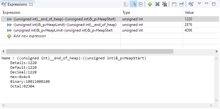

I faced the same thing. My solution is to monitor the heap is using the expressions view, with following expressions:
Used:
((unsigned int)__end_of_heap)-((unsigned int)&_pvHeapStart)
Free:
((unsigned int)&_pvHeapLimit)-((unsigned int)__end_of_heap)
Heap size:
(unsigned int)&_pvHeapLimit-(unsigned int)&_pvHeapStart
I agree that the view should be able to handle FreeRTOS case, but until then the above way works for me.
I hope this helps,
Erich

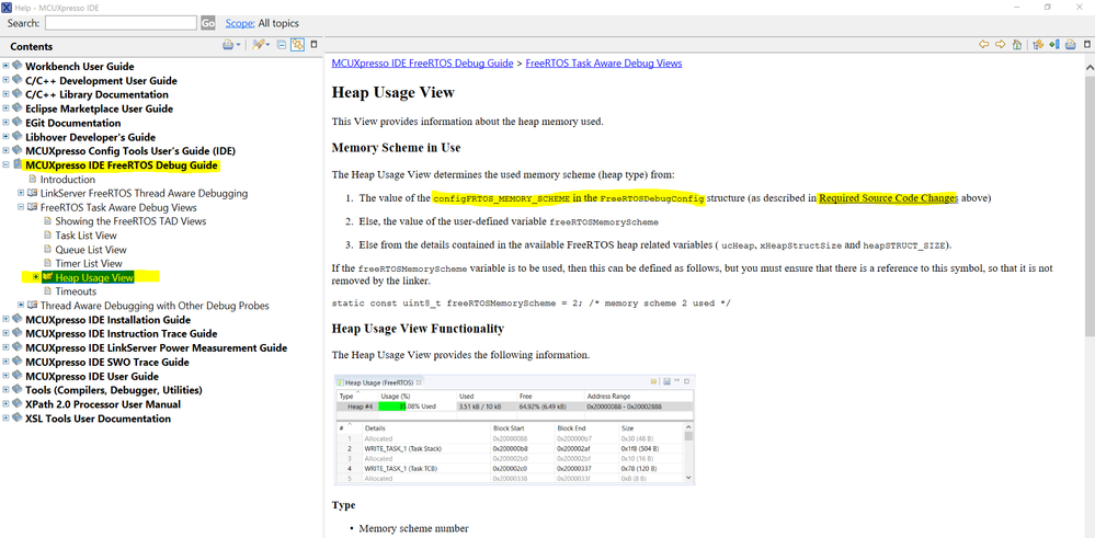

lpcxpresso_supp
First of all, I confirm that the Heap and Stack Usage view is disabled during RTOS debugging session.
On the other hand, there's a dedicated Heap Usage (FreeRTOS) view that does exactly what you ask. Simply open the view by going to FreeRTOS => Heap Usage. Please note that you'll have to instruct the view with regards to the type of heap you use inside the app. I suggest you open Help => MCUXpresso IDE User Guide and then browse to Heap Usage View under the FreeRTOS debug guide for more details.
Greetings,
MCUXpresso IDE Support
