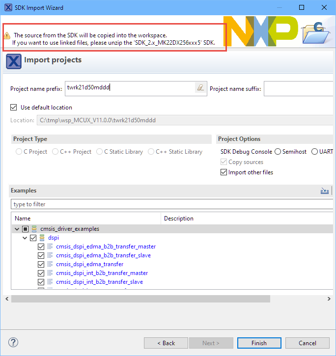

Please tell me how to use own startup file instead of system generated.
7,599 Views
BlackNight
>>If I make duplicate of the same file , exclude original startup file from build then its working fine.Is this right way?
yes, but do this in the project, not in the SDK respository.
If you modify the startup code in the SDK (from where the projects get created/copied), then of course this will affect all projects you will generate from that SDK. I recommend that you add the SDKs as ZIP files to the IDE, then the files will be copied and you keep the original SDK files intact.
I hope this helps,
Erich

I am using MK10DN512VLQ controller with MCUXpresso. Using SDK Development tool I Generated SDK for the same. Every time i create new project i found startup file loaded from sdk. if i change anything in that startup file, the same will affect on another project also. If i delete startup file and add it into another folder with correction which i want, i am facing debug issue which points to sdk generated file is missing.
Now i need solution which eliminate sdk generated startup from compilation or linking.
I think Linking stage makes an error. Where i can change the startup path for linker.

Startup file added to project from that SDK. if i modify from startup file, this will affect another project also.
