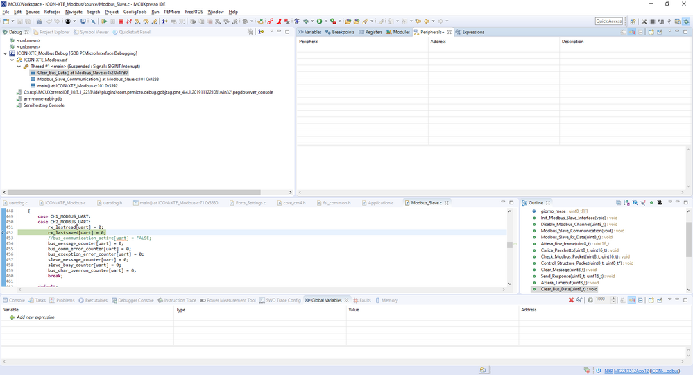

pcpro178
I need to view the GPIO values, but the Peripherals view is empty.  What needs to be done to populate the Peripherals view?  I really hope it isn't to use the NXP Semiconductors MCU Application debugger, because my debug session needs to support preserving some space in Flash memory.  I'm using the GDB PEMicro debugger.

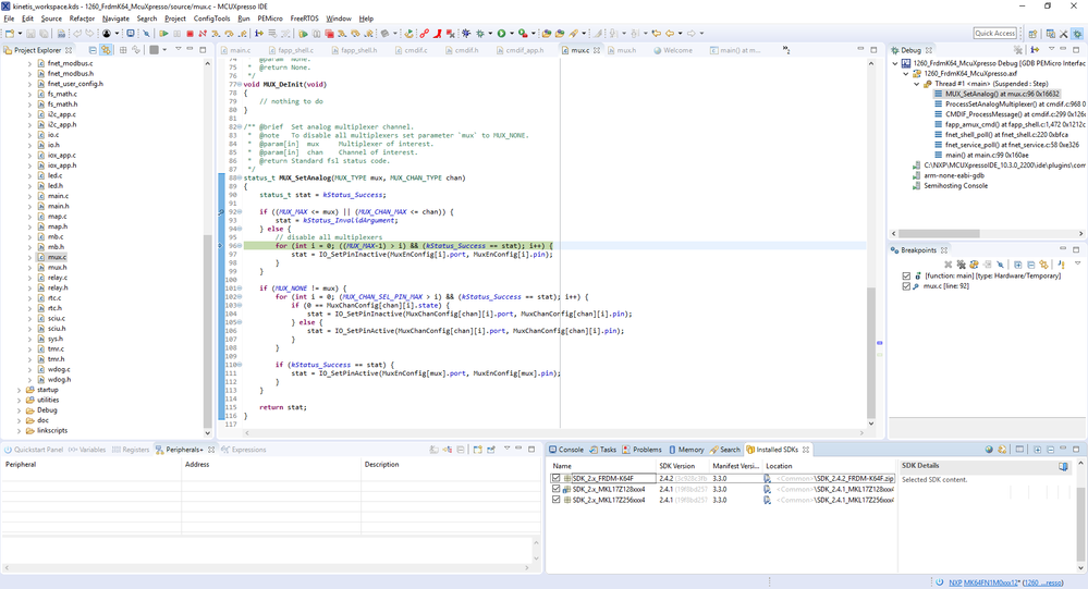

pcpro178
I do have an active debug project.  Here's the screen capture.  As you can see the SDK 2.x is installed.  I am using the FRDM-K64F development board.

BlackNight
Are you using 10.3?
Erich
12,016 Views
pcpro178
Yes, I'm using MCUXpresso IDE v10.3.0.

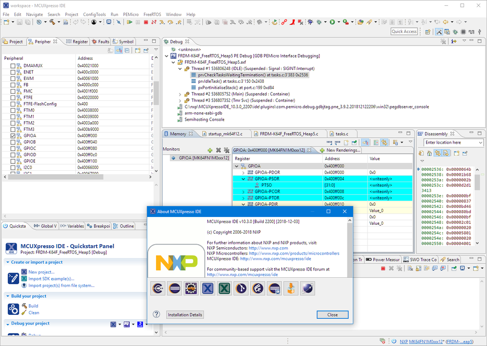

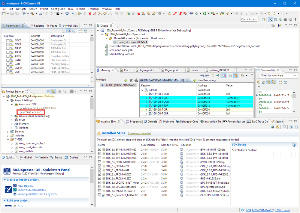

BlackNight
Hi Jim,
I had to remove a few includes, and then I was able to compile it.
I have to say that it works on my side. However, I noticed that your project shows an SDK version 2.4.2?
I don't have that version installed (only the 2.5.0), so maybe this is the issue?
